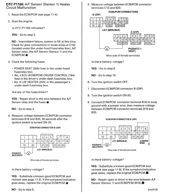

i have a 2001 accord ex 4 cyl codes 1166 and 1167 popped up changed o2 sensor front of manifold but check engine light remains on. any fuses or anything else it can be ? any help appreciated.
Old Mar 10, 2012 | 03:57 PM
Three to start with...one under hood, one under dash-drivers, one under dash pass......
