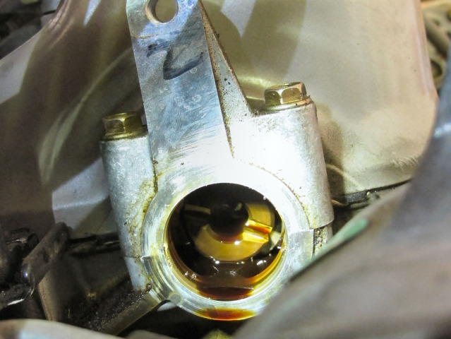

I just replaced the distributor external O-ring on my 97 Accord today so I snapped a few pictures to help illustrate how the distributor blades and camshaft couple together. It was a pretty easy job. The most difficult part is accessing the third bolt that secures the distributor to the motor (12mm); the one you can't see, but you can see the location of the holes in the first picture below. I used a 12mm magnetic nut setter to help with removal and installation of this bolt. There are also three screws that secure the distributor cap (8mm) with one being out of sight. The old O-ring was pretty brittle and just broke apart when I attempted to remove it. Hope this helps.

nice followup, 6-speed, thanks! Not many people do this.
