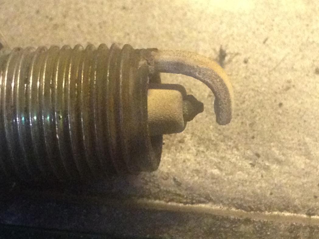

I pulled the plugs and here is what I've got:

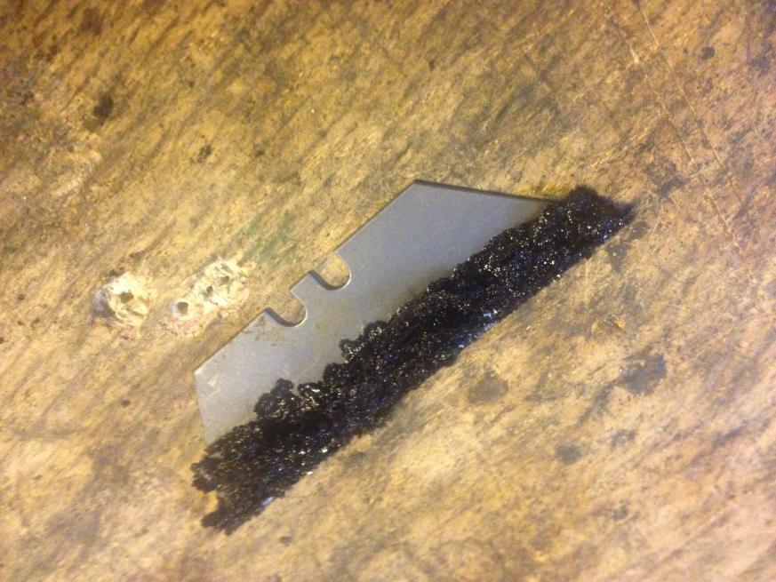

Looked under the valve cover gasket, a nice thick coating of oil, after 255K miles I guess that's expected lol

I pulled the PCV valve too, it still rattled but you could tell it was a little "soft" inside feeling like some goo in there too. I checked it about a month ago and the vacuum was solid.

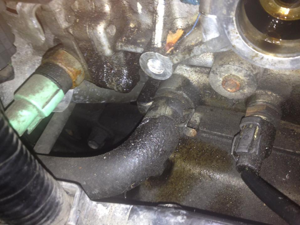

Took the distributor off, and some oil coming from the O-ring. Had it before, replacing O-ring.
https://www.hondaaccordforum.com/for...1&d=1368384345
Took the heat shield off, just for kicks and found some oil down under the exhaust manifold, not sure of origin

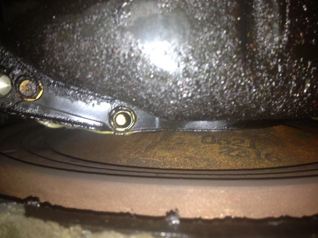

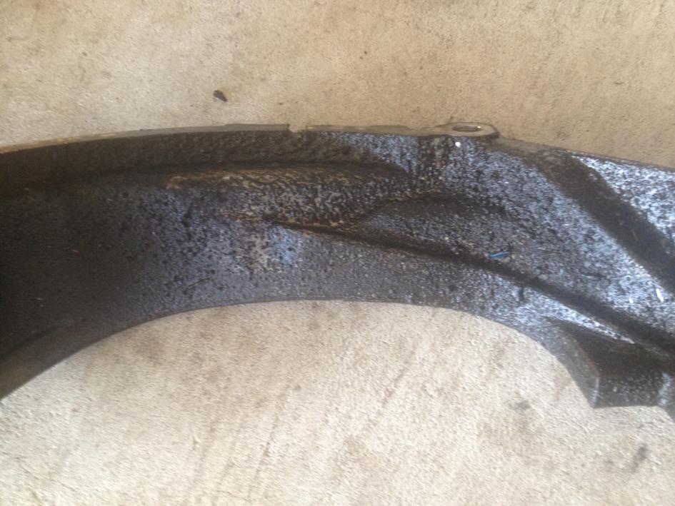

Took the engine stiffener off, a large oil covering coming from that area. Stiffener was covered, as was oil pan. However, oil pan bolts were still torqued properly and the oil was only on the pan/stiffener and not the toothed wheel.

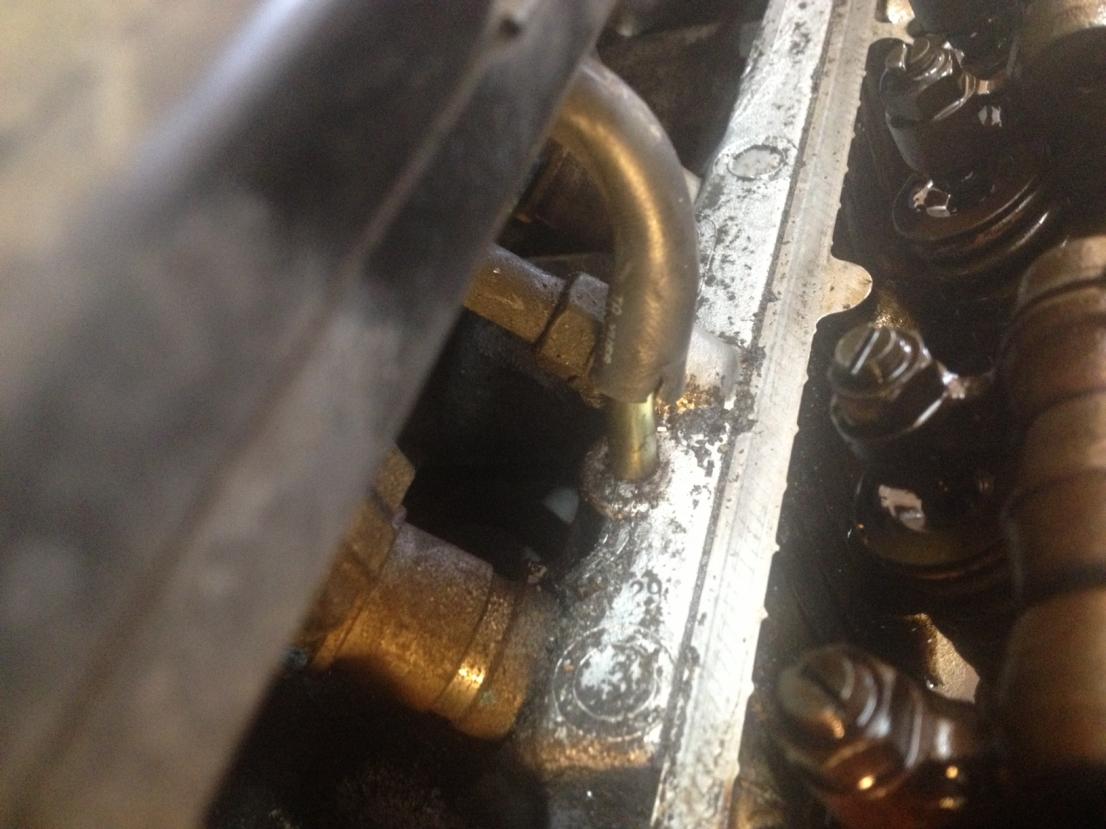

The only other thing I found, and it probably nothing was a small split hose, it's underneath the PCV vavle and hooks to a nipple on the cylinderhead and then goes back into the intake section. Pretty sure that doesn't have anything to do with the situation.
https://www.hondaaccordforum.com/for...1&d=1368384319
