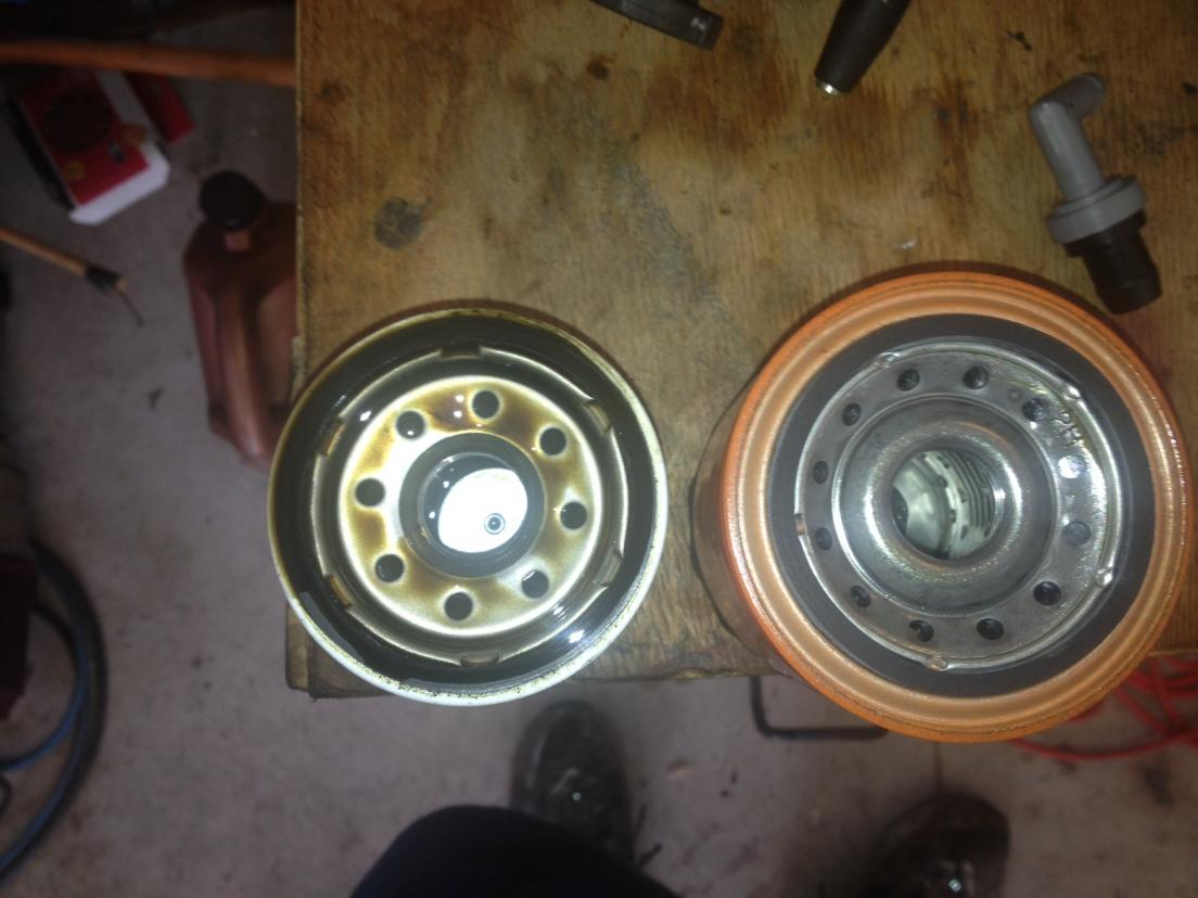

I drained the oil and didn't take the filter, off, I thought it looked strange when I was under there.
The last time the oil was changed is when the car was in for inspection, i normally do it myself but since it was in, let them do it.
They used the wrong size oil filter. You can see in the picture the one on the left is definitely the wrong size. There was no oil leaking from there so it doesn't explain the oil consumption but would that cause any issue?

Did you check the printed model number to verify it's not the right one? If not I would absolutely verify first. The one on the left is white, what is it a Purolator? It looks just like a Purolator L14610 which a bunch of Honda's use. Maybe they assumed your car used the same one? The Purolator site says your car uses the L14459 the top of which looks like the "correct" one on the right so I think it is the wrong one.
I'm not sure that would cause any damage though. Comparing the tops of the two the gasket looks like its the same size which means at least the oil stays within the gasket right? The number of holes drilled into it on the top varies by manufacturer so that's not really a problem. I'm not sure what that lip on the outside of the correct one does but it must be there for a reason and not just because it's thicker?

The one on the left (white) is a Quaker State (QS14612), which is what their website says fits the car. As you can see they are not even close in size. The O-ring is smaller. There was no leaking so I don't think that would have anything to do with oil loss. the only thing I could think of is if it increased oil pressure might exaggerate the oil loss.

Just me, but I'm going to guess that the filter was/is not the issue.
