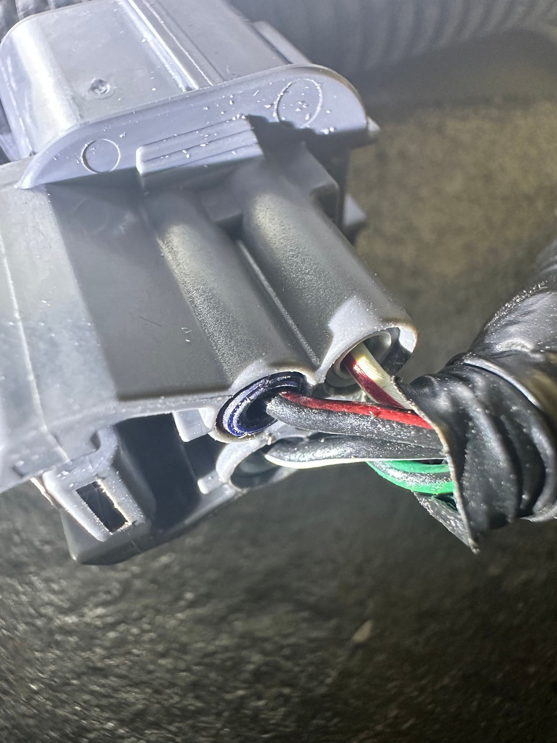

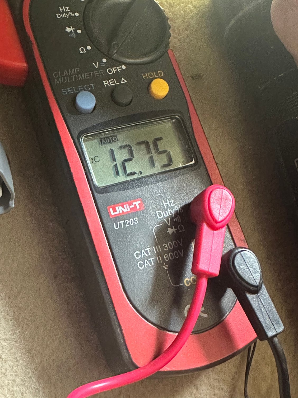

I’m getting a voltage from terminal 4 to an earth
Terminal, 1 green/black Terminal, 2 red/white Terminal, 3 black/white Terminal, 4 black/red
So I disconnected the sensor and got my voltmeter out today, and I’m definitely getting 12 V between number four and an earth, but when I put it between these two terminals, ( 3 and 4 ) the volt meter is fluctuating all over the joint and not giving a clear reading

The blk/red wire at terminal 4 is good based on your testing.
You have a problem with the blk/wht wire at terminal 3 from that connector to the PCM at pin B19. The issue is most likely a broken wire but could still be the PCM. The PCM is less likely since you already replaced it.
For me, the next step would be to peel back a bit of the electrical tape and use a piercing probe to see if you get a voltage reading just past the connector to rule out the connector. Option B is to use a piercing probe just before the pcm at the blk/wht wire at pin b19 and see if you have a ground when measuring voltage. Plenty of youtube videos on pine hollow diagnostics or southmain auto on using piercing probes to test faulty wiring. I'd use the volt meter instead of the test light for now, since you are getting bad ground reading just using the volt meter. It is a safer test to protect the pcm.
