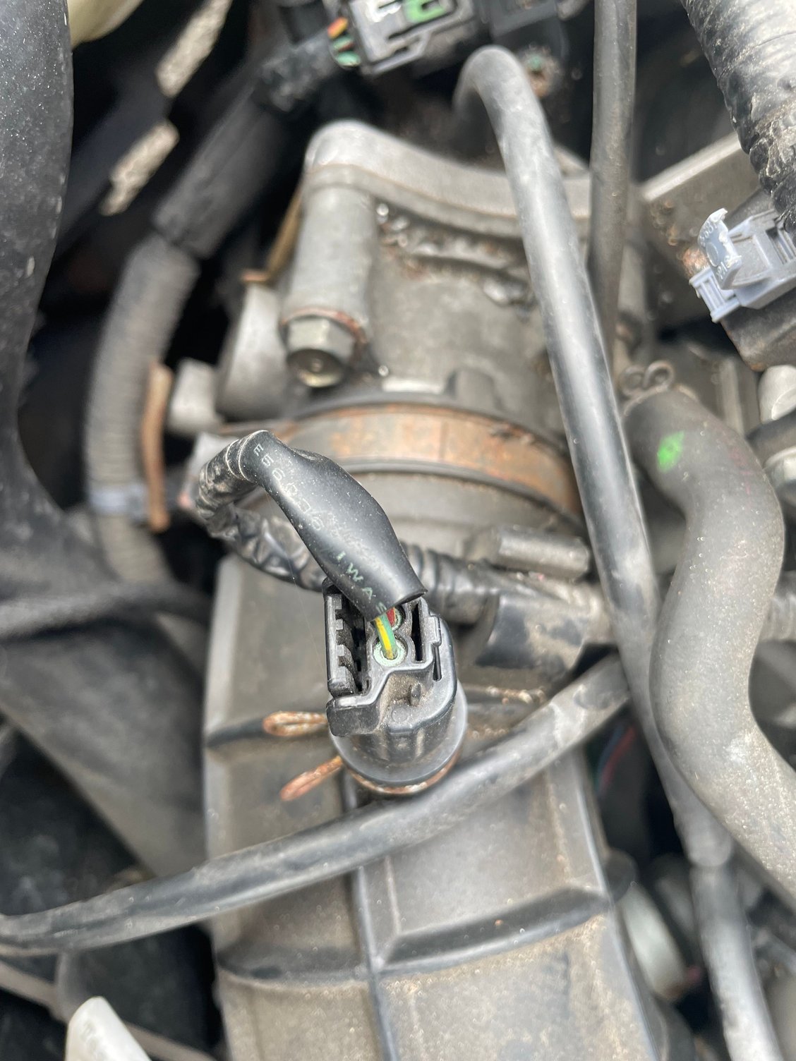

Hi, my accord has had this problem for a while, only happens on motorway journeys, usually 15 minutes into it. Idle is fine, power is ok, no misfiring, no other codes. I changed the plugs, cleaned the air filter. I can't find a MAF by the air filter (there is another sensor along the air duct, [2nd pix] I don't know if that's the MAF, but I can't get it out). Any help, greatly appreciated. Thanks
this is by the air filter. No wires
this sensor further away from the air filter

Your car doesn't have a MAF sensor. That sensor you found is the intake air temp sensor. That hose connection is a vacuum line and I can't remember what it does.

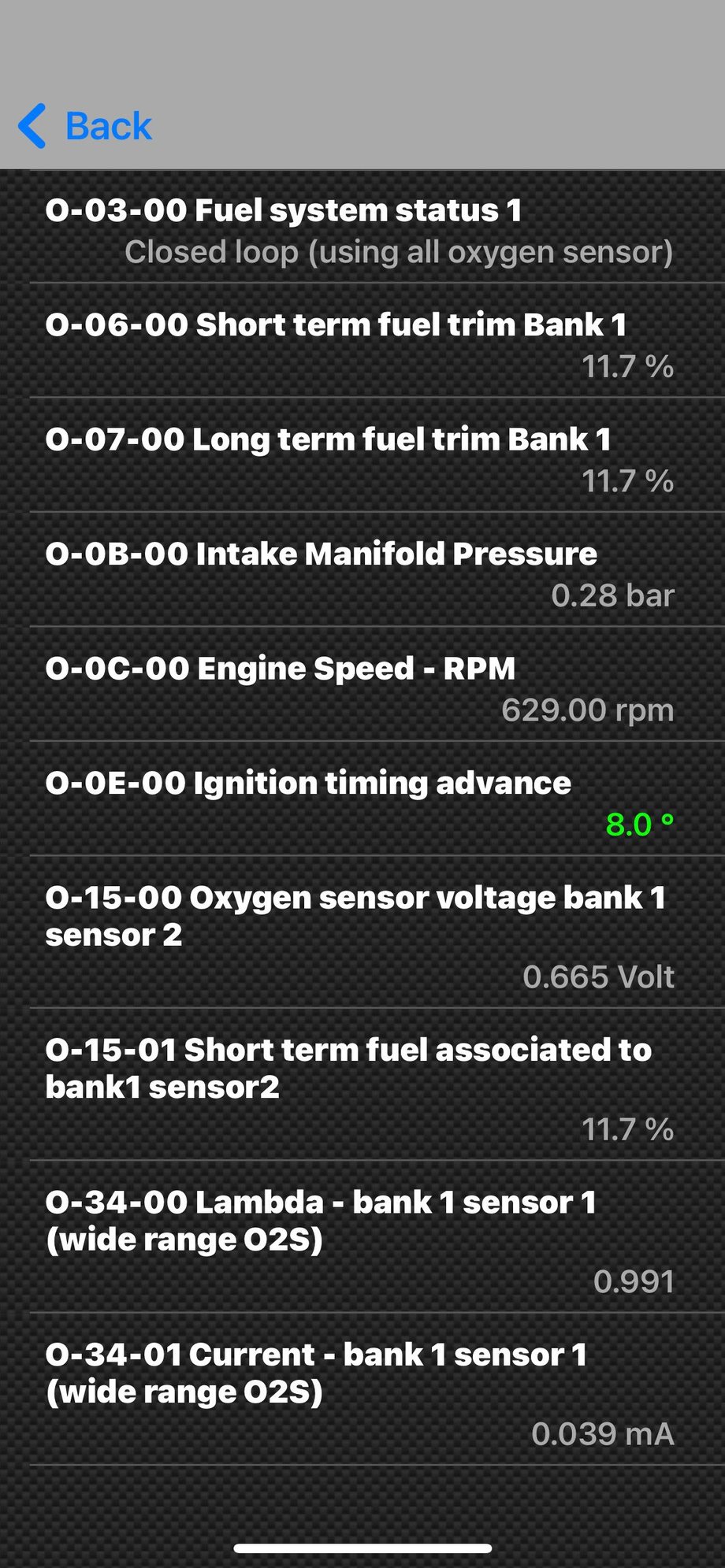

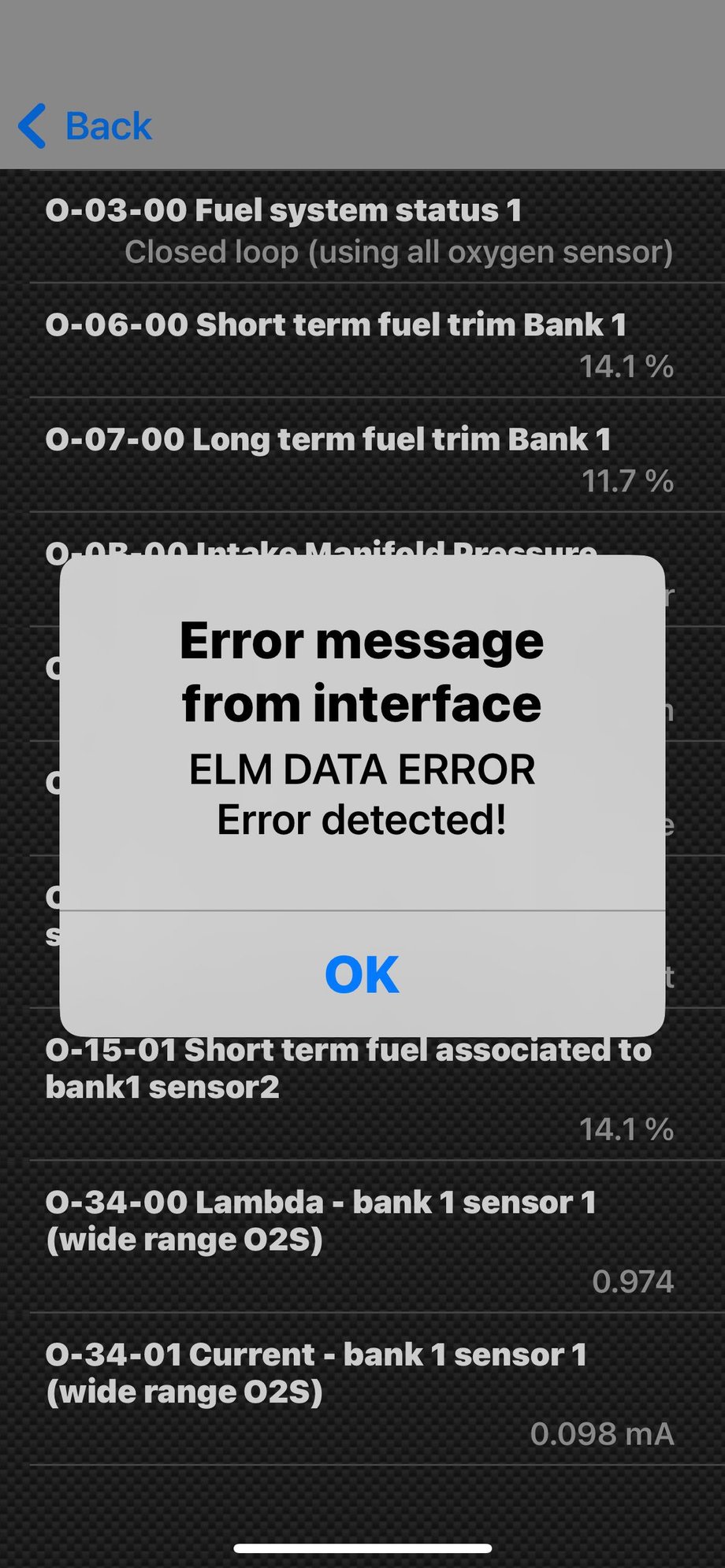

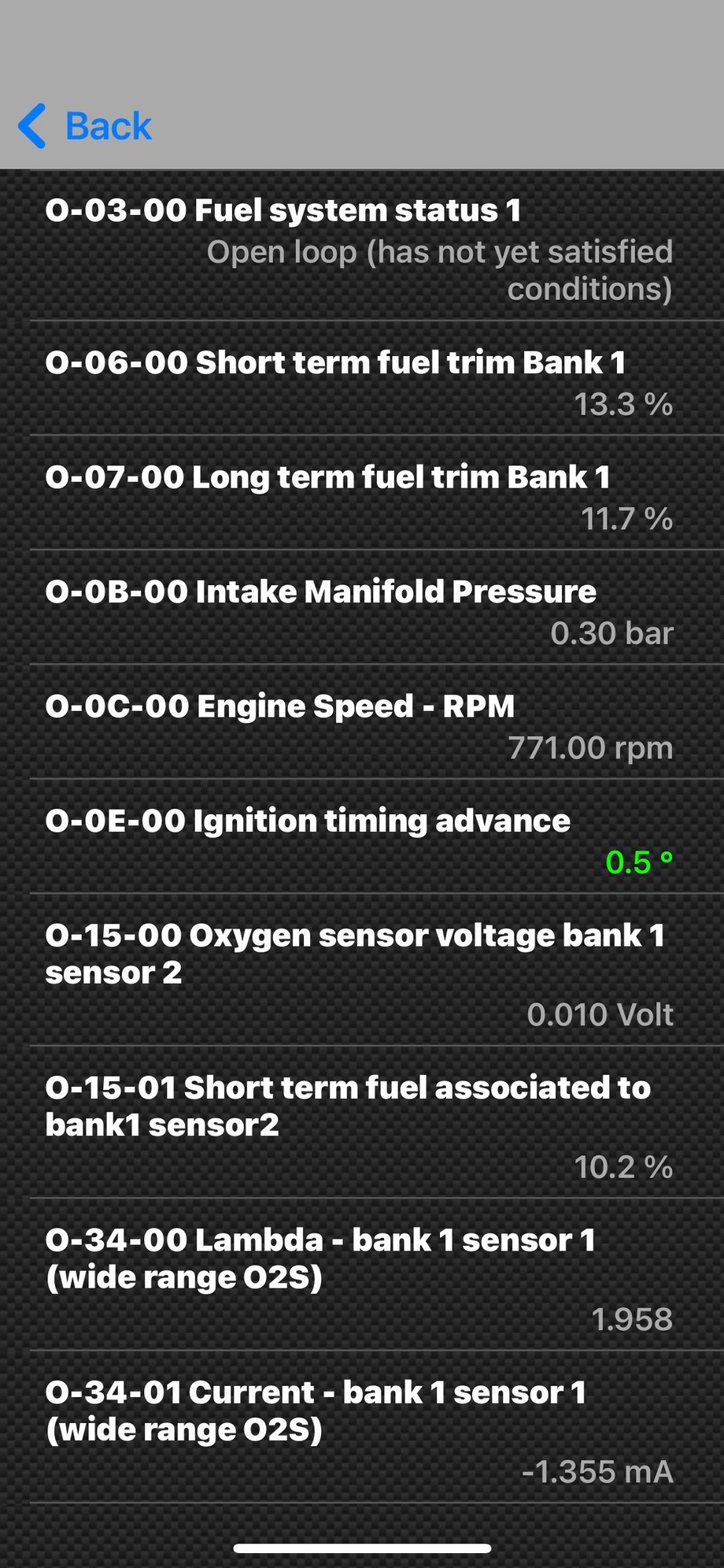

Hi, I just run the tests. Whilst I don't understand the data itself, I have noticed an error propping up every so often (possibly a lambda causing an open loop, Perhaps a false contact?) Please see the pics and movies. Thanks for your help.
idle speed Closed loop - using all oxygen sensors
I got this msg as I accellerated
Back to Idle - Open loop

For the error message, what kind of scanner are you using? This is to google search that scanner code to maybe get a hint.

From the data, the fuel trims are definitely showing a lean condition. The change in rpm doesn't affect the fuel trim, so a vacuum leak becomes less likely. You'll need to do some more scanning to get some direction.
For the plots, can you switch the scale on the map to mm Hg? It is a more useful unit when measuring vacuum pressure. Can you also plot the bank 1 sensor 1 equivalence ratio, intake air temp, and the battery voltage? You can remove the fuel trims if you can only plot 4 at a time.
