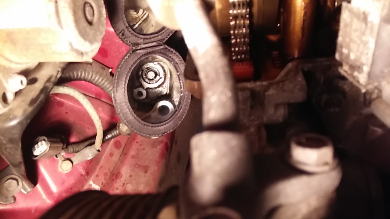

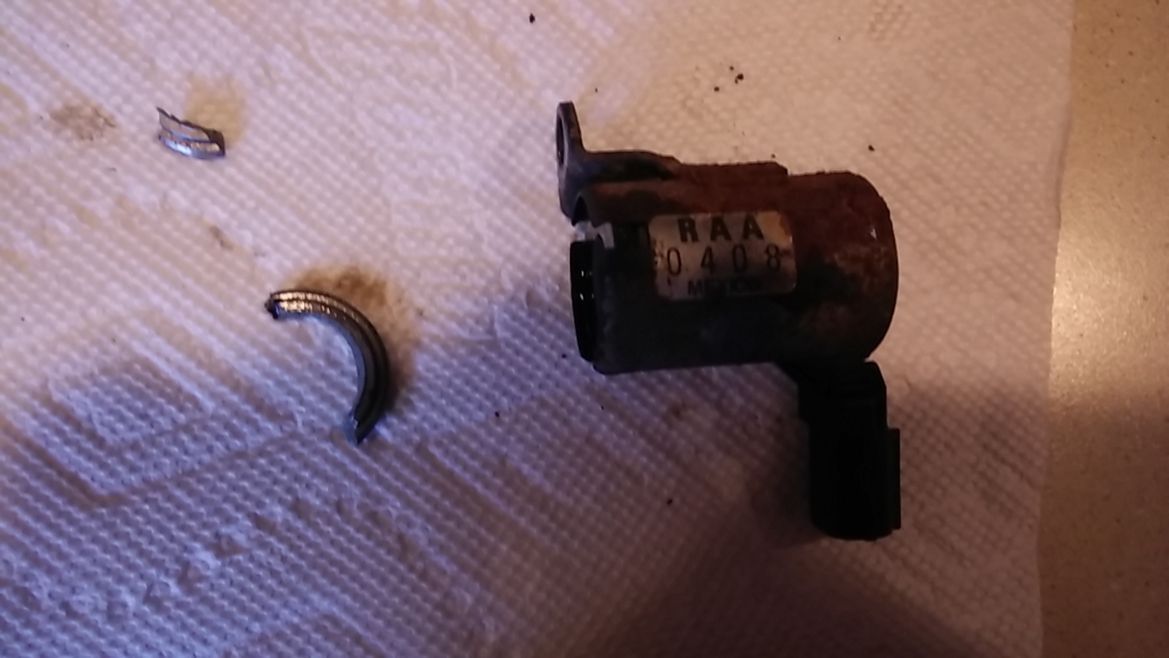

First big problem - I think I broke my VTC oil control valve in half when I pulled it out. See pic. Would I be able to remove the other half when the case is off or will that cause problems removing the case? It was going pretty smooth until that issue. I took a pic through a mirror to show what's left. I tried getting it out with channel locks or a small pic but its not budging. Do I go ahead and take the case off? It's my only option I think.

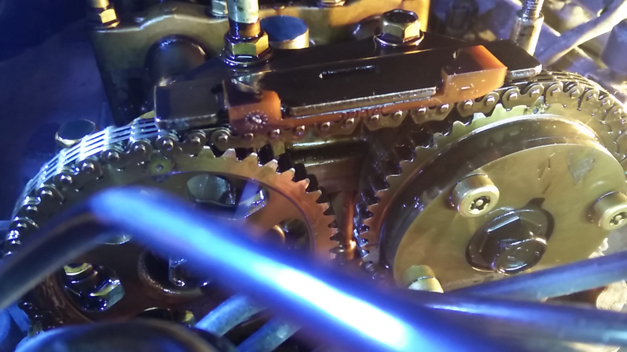

Timing marks lined up good before busting loose the crankshaft bolt but somewhat off after it came loose. I'm guessing the tensioner was compressed and the timing chain jumped when it busted loose. I had to use a 8ft extension on my breaker bar to bust the bolt loose. I thought I snapped something when it came loose.

Did the chain jump off the "teeth"? If not, get a maker and mark the chain to each gear. Then once you remove the chain, transfer those marks to the new chain and intall it with the marks lining up to the ones on the gear(s).
It is nice to start a job with the engine a TDC but at the same time the most important part - IMHO - is the relationship in the marks/length between the gears......I've change a few timing belts without setting the engine to TDC. Of course this all works if the chain/bet didn't jump and that "someone" didn't mess it up before I got there.
I'll have to look more into the solenoid and see what options might be available
