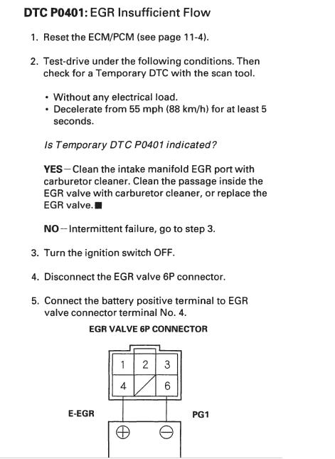

When you cleaned the valve, did you "get the inside" of the valve. You have to apply voltage to get the valve to open. Then sometimes they do go bad....If it was my car I would clean the valve first.

I actually cleaned the port too. I did a recheck of my work though and found that the egr itself was not opening completely every time, thus possibly causing insufficient flow. I'm going to have to buy a new one this week to see if that solves my problems.
