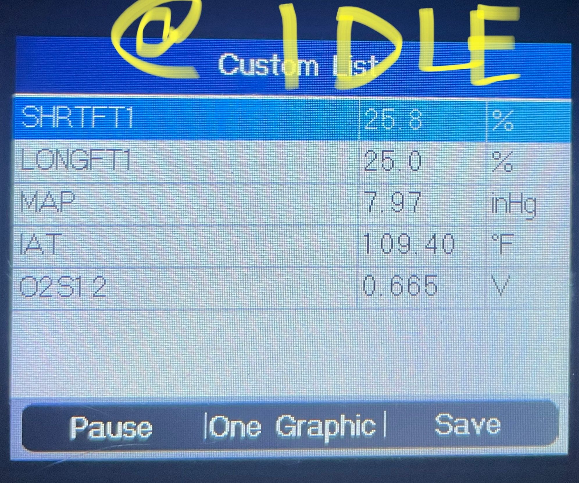

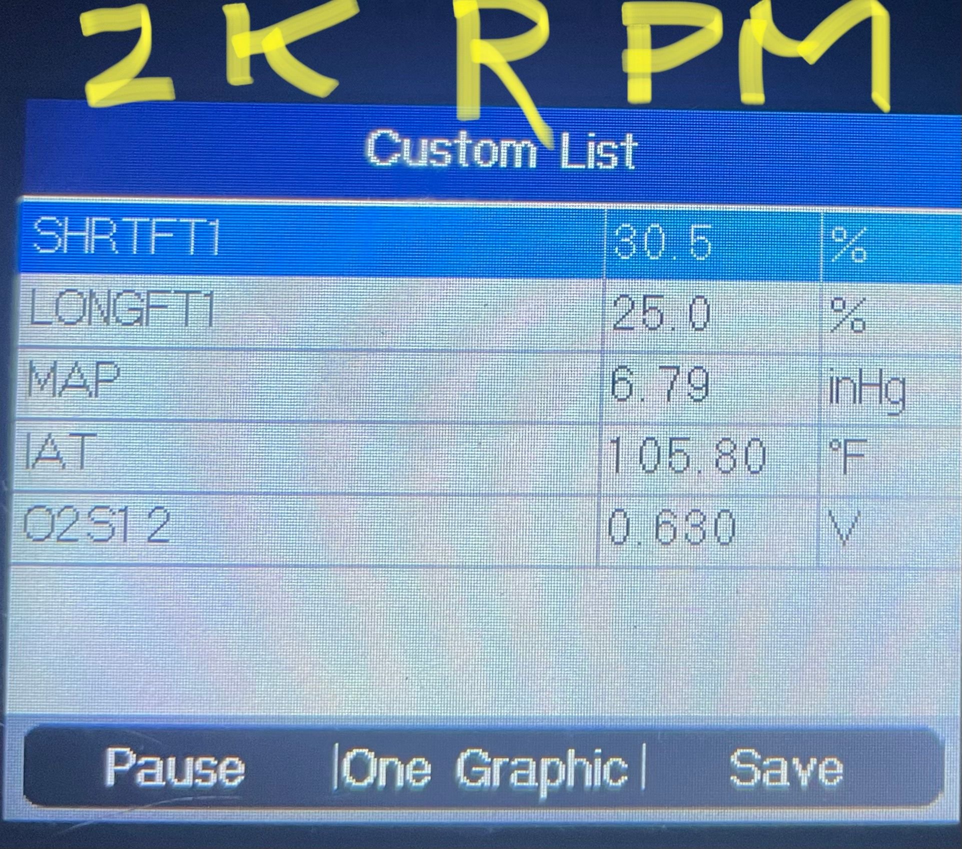

Alright! So I just did the live data test. Here’s what’s going on: ***There was no CEL, and no stored or pending codes. I/M readiness is all OK except Evap monitoring (INC). NOW, the CEL came back on when I started the car up to park elsewhere. This time, it’s P0171- System too lean bank 1. I DID already just change the MAF. You can’t make this stuff up 😆

The scanner information is helpful, but missing a few items. Can you repeat the same test and include the MAF (not map) sensor along with the engine coolant temperature sensor(s) and open/closed loop. it may be called fuel status, or just google to find out how your scanner identifies open/closed loop.
Can you plot both O2 sensors at idle and 2000 rpm? From your screenshot the label would be O2S1 1 and O2S2 1?
Based off of this test, your car's PCM is adding fuel with the high short and long term fuel trims. The trims didn't change at higher rpm, so a vacuum leak is less likely. With the information so far, the MAF sensor can be way of, low fuel pressure, an issue with one or both O2 sensors, engine coolant temp sensor, or maybe the catalytic converter. The next step is to narrow down with further testing.
