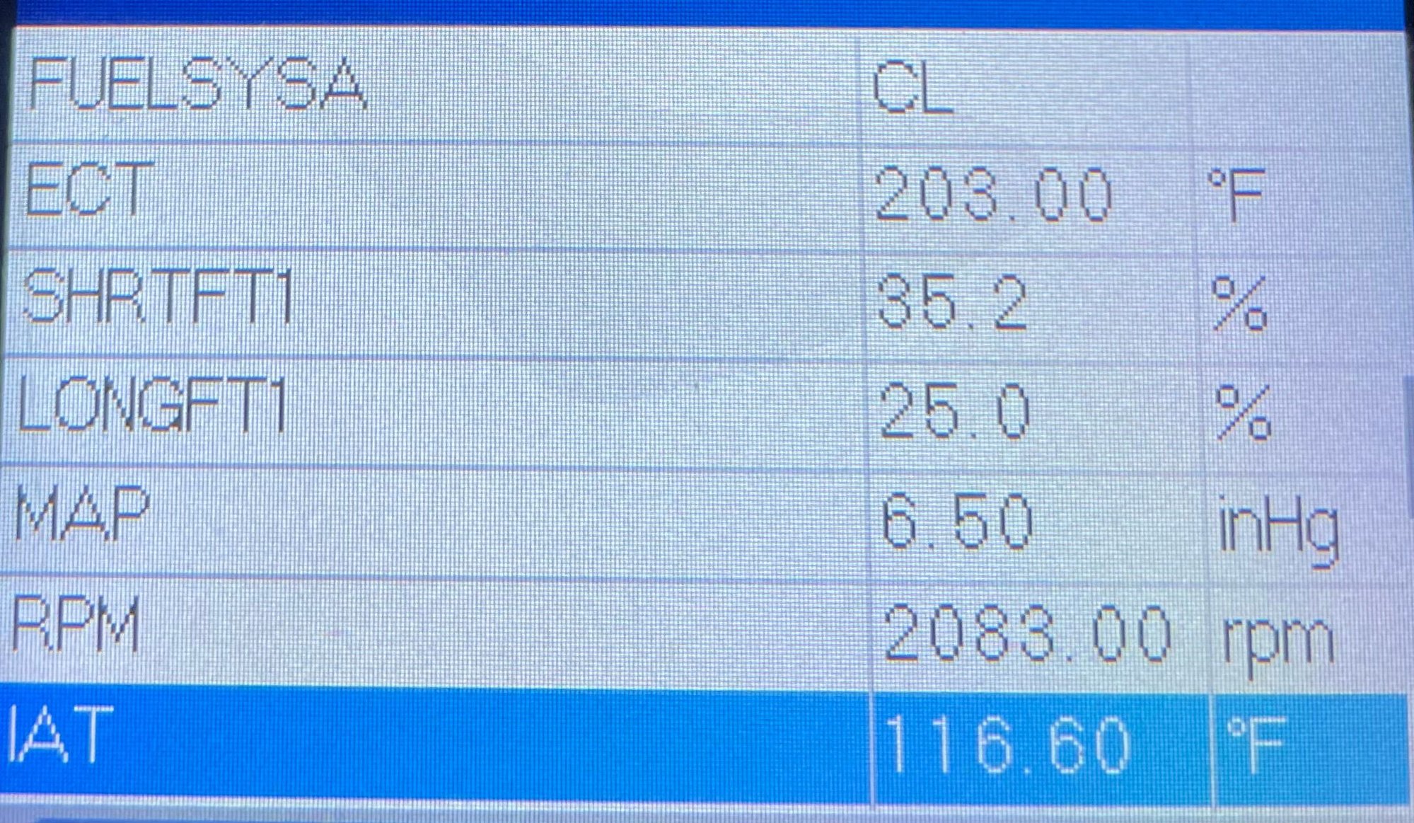

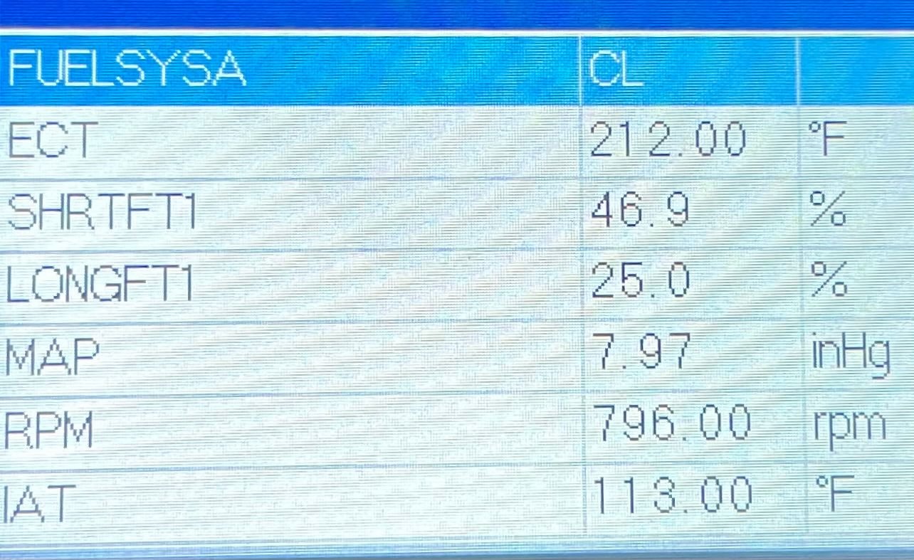

Ok, Here’s the new readings;
Image 1 @ idle
Image 2 @ idle
Image 1 @ 2000 RPM
Image 2 @ 2000 RPM
Current codes; all monitors OK.

There are some differences between your numbers and mine. Your fuel trims are showing a severe lean condition.
The biggest difference is the MAP. My MAP is showing more vacuum at idle than your readings. Low intake vacuum could be caused by a number of items like timing, low engine compression, restricted exhaust/intake, faulty reference voltage. You'll have to start narrowing down potential root causes. Start simple and check your air filter to see if is severely clogged. Do you have the old catalytic converter? I'd also spray down the new exhaust manifold/catalytic converter area with soapy water to see if you have an exhaust leak. I'm not sure this would cause the map reading lower vacuum.
Your coolant temp is high enough where you cooling fans should be running, but I don't think this would cause your lean/P0420 problems. When the engine is cold, remove the radiator cap and top off the radiator. Inspect the radiator fins for damage or debris blocking air flow. With the engine running, turn on the a/c and make sure both fans are running. It is good to check your cooling system.
My O2S1 1 on equivalence ratio jumped between 0.975 and 1.025, so the value was oscillating. Plot both O2 sensors in a chart to see how each behave. The O2S2 1 should be flat lined and not oscillating.
IAT was similar to yours, so not an issue.
