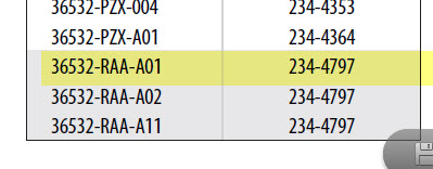

For a USA built, 2003 EX, 4 cylinder, AT with 4 doors, the Honda part number is 36532-RAA-A01, which cross references Denso 234-4797. So, the number you had in the first post is correct.
Just make sure your Accord is USA built which you can tell from the beginning VIN letters (J for Japan, built etc.).
Attached Thumbnails Which Part# for 2003 Accord EX O2 Sensor?-denso-cross-reference.jpg
