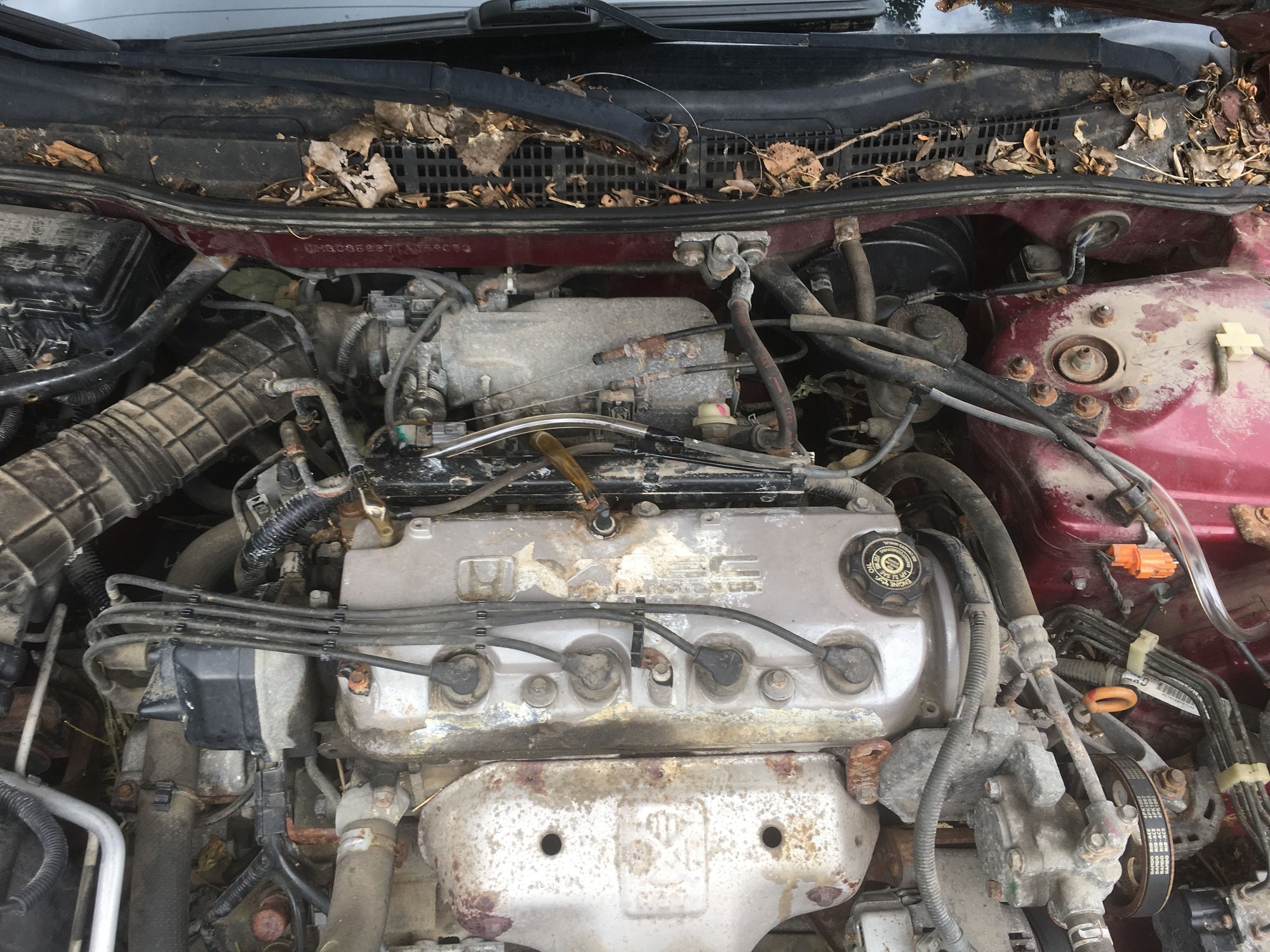

Trying to find part names for the lines indicated in the picture. Any help greatly appreciated.
This image has more clear arrows... I need to know the names of the two vacuum lines indicated by the arrows...

Please put your car's information in your signature. I owned a 95 4-cylinder EX, so I can tell this is a 94-97 EX accord.
I can remember where those vacuum hoses went. Take a close look at the vacuum hoses. If they are original vacuum hoses, then there should be a number printed on the hoses in white lettering.
What is the issue you are having?.

it's 98-02 generation 4 cyl.
one of them goes to the cruise control unit, the other to the fuel damper.

yeah. That is a clean engine. Ours is a 2001. We bought it for our high school kid to drive. In the 6 months it sat in the previous owners driveway, it became home to some packrats who dined on various vacuum lines. I managed to find and replace most but these two stumped me... We have temporarily patched it with pvc tubing but would like to get the original parts on it. Here's a picture of the actual car...

The numbered vacuum hoses from the factory are probably pointless. Get some vacuum hose of the right size from auto-parts store where you just buy it by the foot. Dealer probably doesn't even have pre-cut hose with numbers printed on it...
(I bet that clear tube won't take the temperature for a long time.)

Could we be looking for "hard" lines? Honda parts website. #3?
https://www.collegehillshondaparts.c...-pipe-tubing-4
