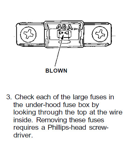

Double-check the No. 21 (50A) large fuse in the under-hood fuse box. See attached pics.
If replacing, disconnect the negative battery cable first before working on it.
Attached Thumbnails Please Help No Power to the Driver side Fuse Box-under-hood-fuse-box.jpg   Please Help No Power to the Driver side Fuse Box-checking-large-fuse.jpg
Already check Fuse still good, check every other fuse also still good thats why im lost not sure which one runs the fuse box inside.

The No. 21 fuse in the under-hood fuse/relay box was one that ran power into that side.
