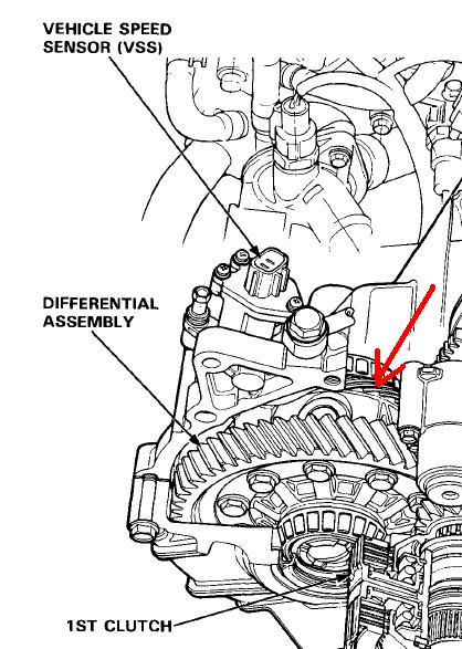

Default 94 Accord VSS Update
Hey Texas & Poorman -
I can't get a picture of what's happening inside the tranny, but I will describe as best I can.
The ring gear inside the tranny which engages with the gear at the bottom of the VSS drive link is reachable with my finger (VSS drive link removed) through the VSS drive link hole, and I can move that gear from side to side and spin it around easily. I can only assume it has become disengaged from it's seating. This ring gear does not appear to be plastic, as someone mentioned. From the little I can see through the hole, it appears to travel in-conjunction with, and around, the left axle.
Ordered a JDM tranny from Texas, but haven't confirmed on shipping. There's still time to wriggle out of it, should a Honda angel care to enlighten me on the repair shortly. I've spoken with nearly 20 Honda experts by now, and none of them have ever heard of this problem.

  #54
You've pulled the entire vss and drive assy out of the trans and the gear at the very bottom of the drive assy is ok?

  #55
joe94wag's Avatar
Joined: Sep 2014
Posts: 51
Oh yes, I did that a long time ago. I have both versions of the VSS drive unit. I am talking about the gear inside the tranny - the ring gear that goes around the opening for the left axle.

  #57
I looked for a bit yesterday and the best I can come up with is that the gear that drives the VSS gear os part of the diff assy?
I didn't see anything about being able to replace it...press on or off.

joe94wag's Avatar
Joined: Sep 2014
Posts: 51
Yes! I've seen this diagram, and that is the gear indeed. I also didn't find any mention of changing the gear or what the gear is called.
