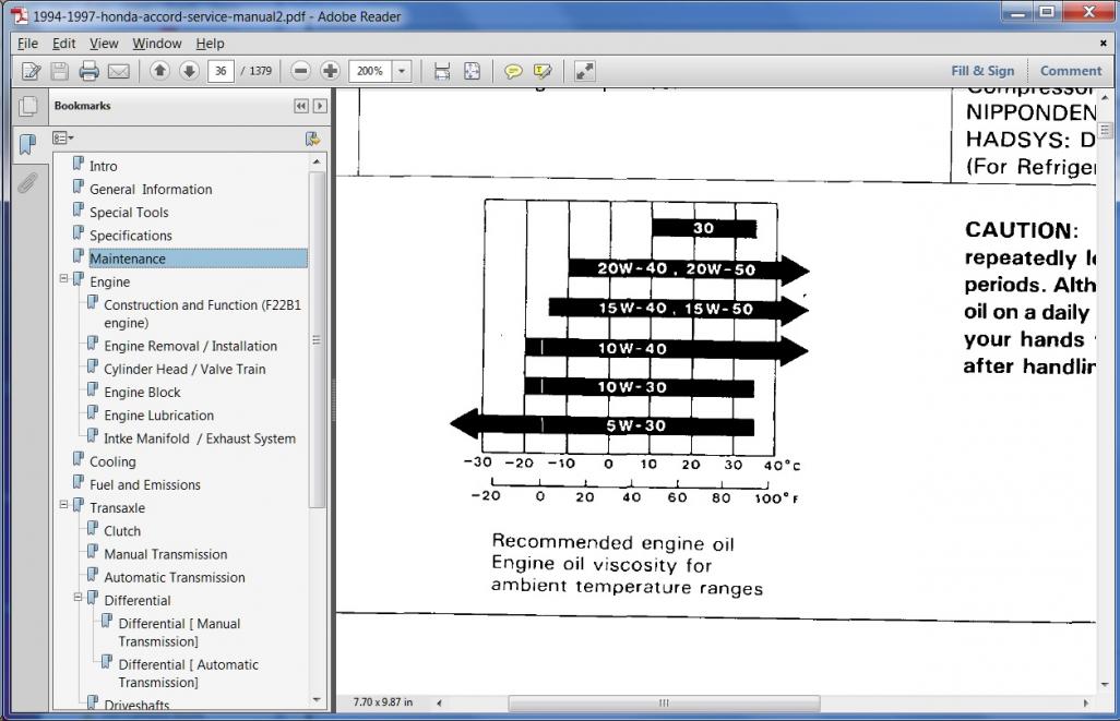

I checked around, and it looks like the first thing I could try is to up the viscosity of the oil. I'm using Penzoil dino 5w-30, but in the SF Bay Area our temps range from 50-90F and rarely ever get below freezing in the winter. Based on the attached chart found in the service manual, I should be able to go up to 20w-50 if I want.
I will start with 10w-40 on the next oil change and see how it goes.

It's still not worth it. The car needs some body work as well (was hit in the right rear quarter panel) which I am not planning to spend the money on at this time.
Even if you change to 15W-60 grade oil it will not help the blow-by.

well, maybe it will at least help suppress the oil drips a bit more.
Currently the dripping issue is relatively minimal. Occasionally -- but not every time -- when I park the car I will get a drip wet spot maybe 2" in diameter. I can't tell when this happens because when I drive the car to work (8 minute commute, including one freeway exit) I don't seem to get an oil spot. So I'm trying to figure out when the oil seeps out. When it's cold only? When it's hot? freeway driving vs local driving?
Anyway, if by thickening up the oil a bit will allow it to withstand the crankcase pressure better and not seep out around seals, then I've pretty much solved my short-term problem.

Using a heavier grade of oil will NOT reduce crankcase pressure or oil leakage; folks have been trying that trick for literally decades now and I've yet to see even a single success story.
As I see it, your two options are to deal with the car as it is or swap out the engine.
