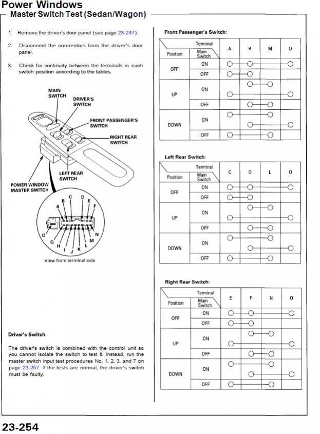

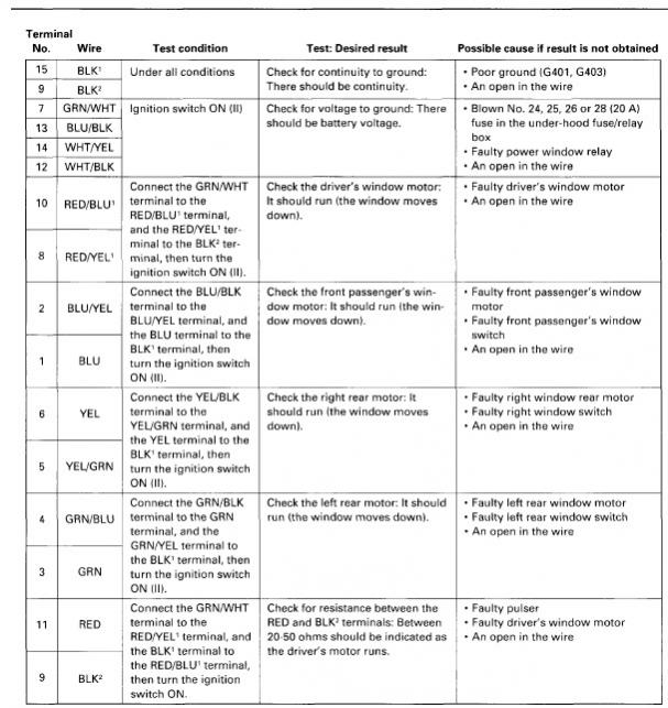

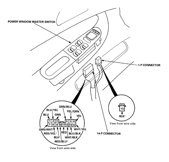

You are going to have to use a volt meter and do some electrical testing on the driver's door panel. I attached pics of the switch test, and the test of the wires leading into the master switch.
Attached Thumbnails Is it possible to "hot wire" the rear window motor?-wire-tests.jpg   Is it possible to "hot wire" the rear window motor?-locations.jpg   Is it possible to "hot wire" the rear window motor?-switch.jpg
