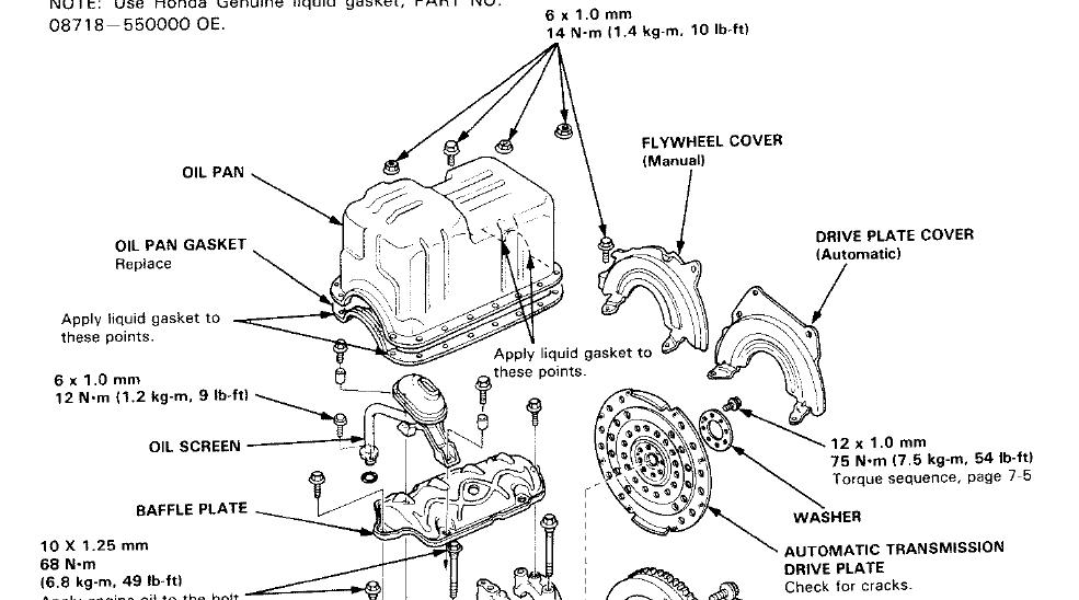

Oil pan gasket: dry or use sealant?

At the very least you want to use sealant in the "humps" of the pan.
Attached Thumbnails To pull or not to pull engine for clutch/engine work. '88 LXi-3rd-gen-oil-pan.jpg
