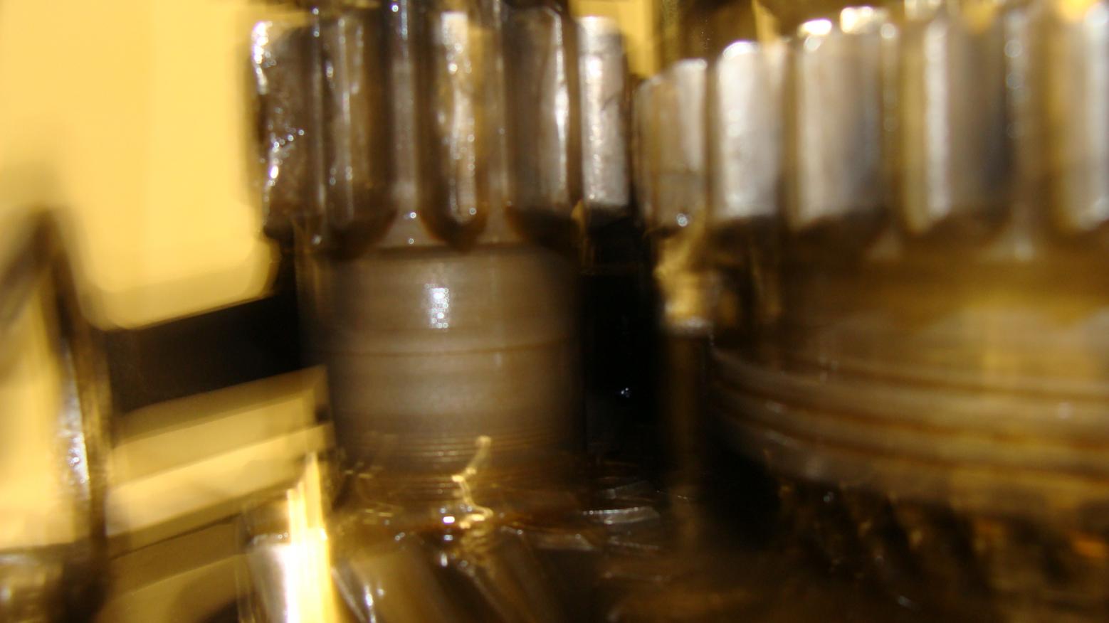

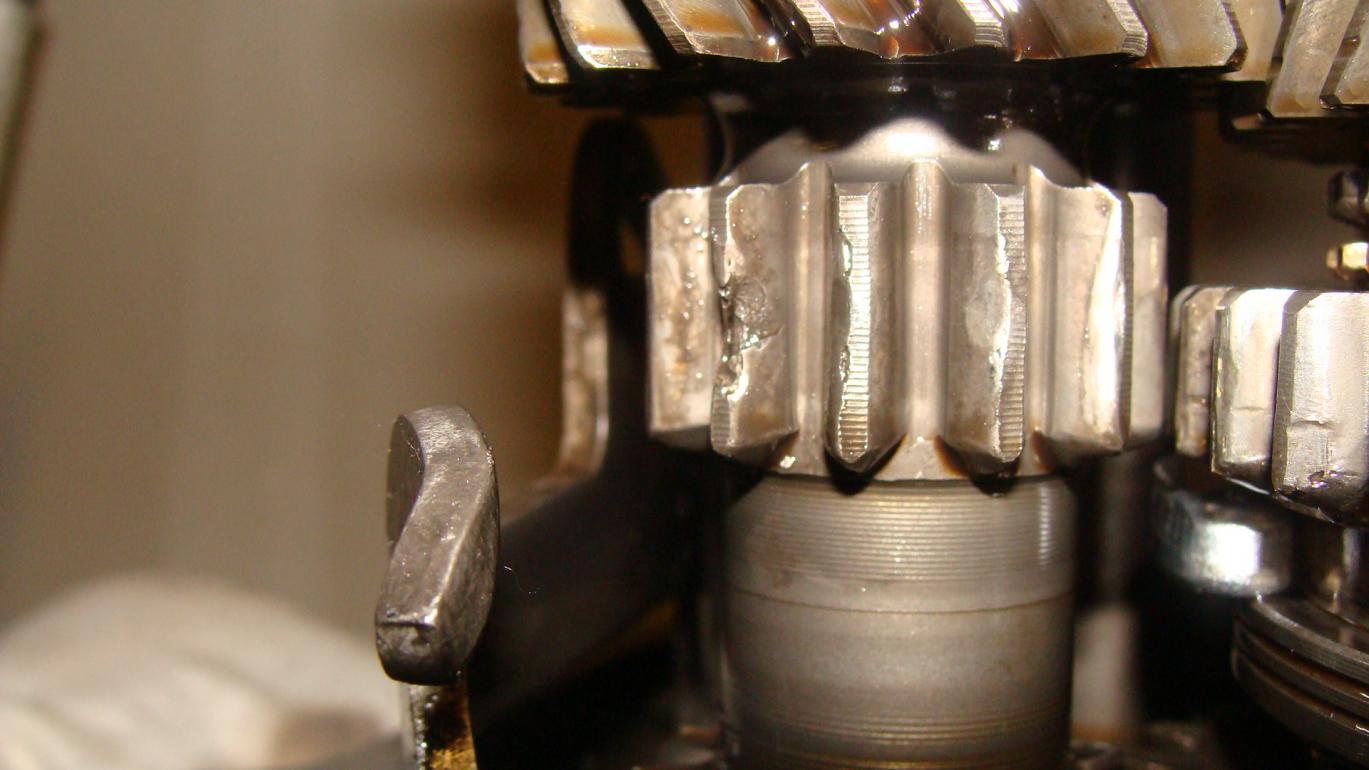

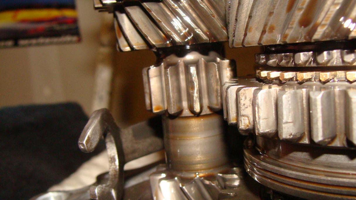

After much thought I decided to pull apart the transaxle to check out the noise when in reverse. Regrettably, there is damage to the main shaft and corresponding gear on the counter. It seems the mainshaft is no longer available from Honda. Plus, the asking price was in the $250 range. Frankly, even if it were available, I wouldn't spend that much, as gears 1-5 work fine with no noise. But, if I could get it cheaper, I might. Any ideas?
Attached Thumbnails To pull or not to pull engine for clutch/engine work. '88 LXi-dsc01792.jpg   To pull or not to pull engine for clutch/engine work. '88 LXi-dsc01793.jpg   To pull or not to pull engine for clutch/engine work. '88 LXi-dsc01791.jpg
