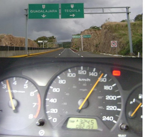

Still, I have this idea that the engine is holding back. On my 2002 F23A1 I could cruise 100mph at just over 3k RPM, (I´m at 5k ft. not sure if that matters),
And this 2.2 seems to struggle to reach 90mph. Filters, spark plugs, oil, etc. has been checked.
Mostly I just want to ensure the ECU does not go into some mode that burns more gas, I didn´t get this car to race around.
Thanks!
-edit; picture of my previous Accord, a 2002, on the Mexican autobahn
