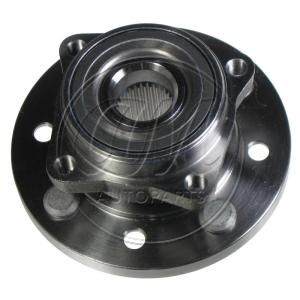

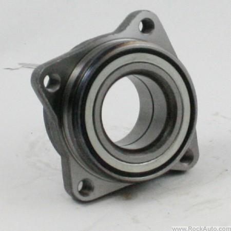

I am planning on replacing my driver's side wheel bearing as I am hearing the telltale "howling" noise. The passenger side was done last year by a shop, and I want to do the other side myself. I'm a little confused about what situation requires having the bearing pressed out and the new one pressed in.
Sometimes I see the first picture described as a "wheel bearing" but also as a "wheel bearing and hub assembly".
But in my mind the second picture should actually be considered the assembly.
If I purchase what is in the first picture, will I still need to have it pressed out/in at a shop?
I also want to replace the CV axle at the same time. Besides a new axle nut, is there anything else I should buy to replace at the same time?
Yes. The second pic shows the assembly which wouldn't require pressing.
Replacing the bearing alone doesn't necessarily require a press; there are workarounds. See youtube video FEDrioMDe1k.
The hub/bearing assembly isn't much more expensive than the bearing alone.

Where can I get the true "wheel bearing and hub assembly" in the second pic for a decent price? The only place I was able to find it was a web parts place called AM Autoparts, but they have a lot of negative reviews. I've seen a few others here and there but they were all over $100. I can get the bearing alone (pic 1) for $15-30 from Rockauto.
Please let me know as I'd rather do this as simply as possible if it is only a bit more $ for the hub/bearing combo!

One of this site's sponsors, TheAutoPartsShop, has a National brand assembly for $69 shipped.
Edit: maybe not. No pic shown.
Edit #2: I'm guessing it's just the bearing, not the hub too. My favorite wheel bearing source, HubBearing(dot)com is apparently out of business. They used to sell the complete Timken (NSK) assemblies for ~$60. Sorry for leading you down the wrong path.
I successfully replaced the passenger FWB using Eric's video (but with no air tools) using his cutoff wheel method. The only hitch: a hunk of hardened steel sliced right into my face when popping the race off with the chisel. Wear a full face mask, not just safety glasses. Freeze the hub in your freezer for an hour or two, and warm the bearing in the sun, before "pressing" them together(8:25 in the video.)
Hmmm... I don't see it on that site. I see this:
Brand: National
Part Number: 94honaccord/513098
Category: Wheel Bearing and Hub Assembly
Condition: New
Description: Hub Assembly
1994 honda accord LX 4 Cyl.2.2L -Front Wheel
Price: $46.09
But there is no pic, so no way to tell if it is a "true" assembly, or just the bearing itself. It seems a little too good to be true that it is the bearing and hub together, since the hub alone shows for over $90...
I guess I will give them a call tomorrow and see what's what.
There is one on ebay for $64.90 shipped from a seller called 1aautomotive, but I'm always wary of ebay parts sellers when it is something that is kind of hard to find elsewhere...
Old Mar 31, 2013 | 12:30 PM
I can tell you this - a National 513098 is just the bearing.
Old Mar 31, 2013 | 12:54 PM
joenintiesc's Avatar
Posts: 22
Yes, that makes sense. Another example of the mislabeling I was talking about by referring to it as a "Wheel Bearing and Hub Assembly"...
So it looks like either I will have to do it the hard way/ DIY youtube method(s), or take a chance on the ebay ACTUAL Wheel Bearing and Hub Assembly I mentioned.
Thanks for helping me sort this out!
