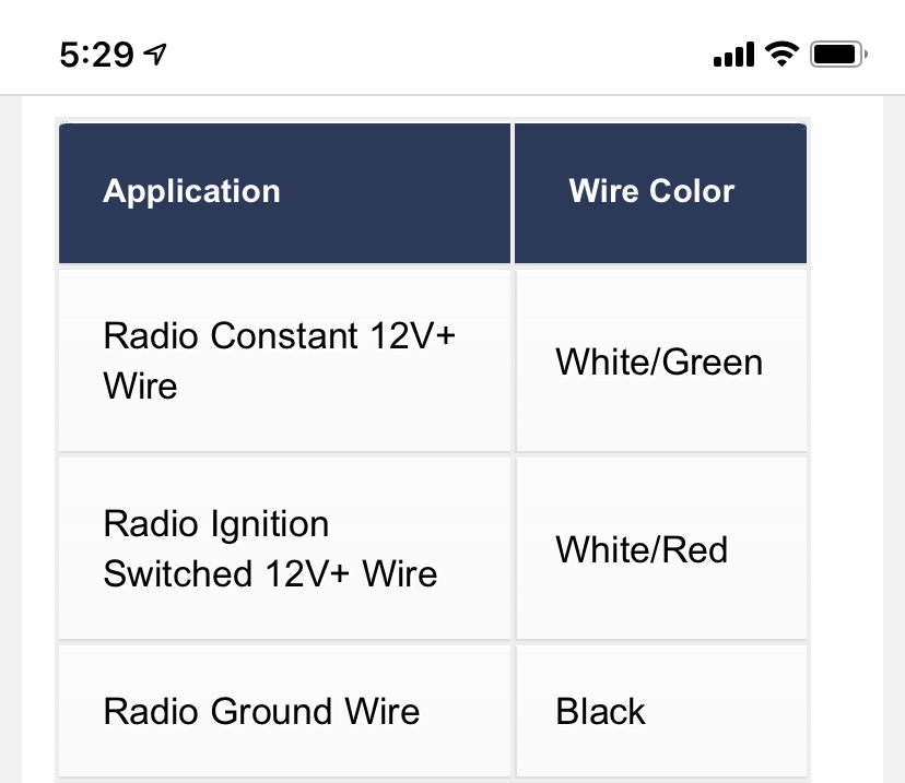

My radio doesn't work. But my accessory outlet does. I know they are on the same fuse in the passenger side compartment. Is there another fuse I should be looking at?

I do know. You are going to have to check the wiring. I'm trying to find the diagram so you know what to probe. I'll post it once I find the diagram.

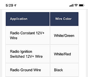

The wires below is what you want to probe to see if you are power
