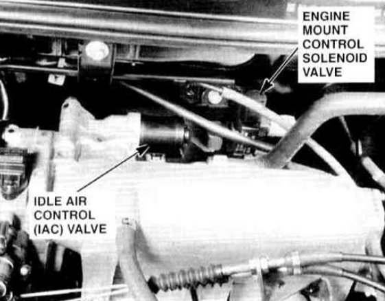

Nope i ment iacv. This thread from honda.tech said its on the back of the intake manifold. And i checked and i believe it is.

this should clear up any location questions...
Old Apr 11, 2013 | 06:42 PM
Yes, that is same location as my 94 EX and it can be done w/o removing intake manifold.
