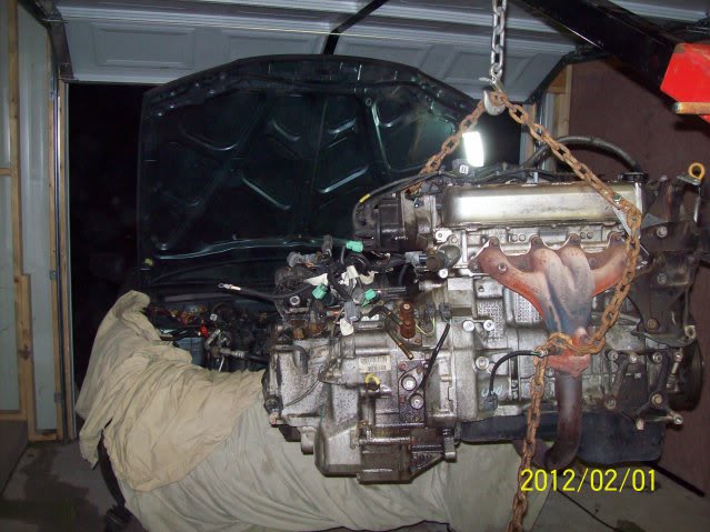

Old Feb 1, 2012 | 07:45 PM
crispin's Avatar
Joined: Sep 2010
Posts: 1,653
From: Tennessee
6 hours after starting
Old Feb 1, 2012 | 08:02 PM
nice, not a terrible amount of time. Just think of the money you saved yourself as opposed to sending it to a shop!
What is the reasoning behind removing the engine?
Old Feb 1, 2012 | 08:09 PM
crispin's Avatar
Joined: Sep 2010
Posts: 1,653
From: Tennessee
nice, not a terrible amount of time. Just think of the money you saved yourself as opposed to sending it to a shop?
The Auto trans blew
I bought a 5 Speed Accord with a blown motor.
I am going to swap in the 5 speed trans for less than $200 total (that is the goal)
