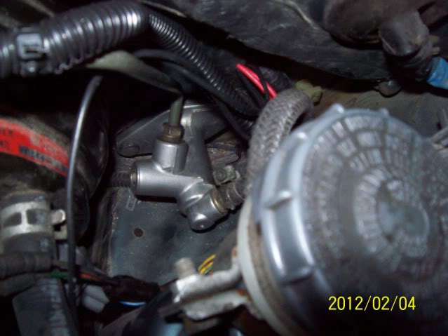

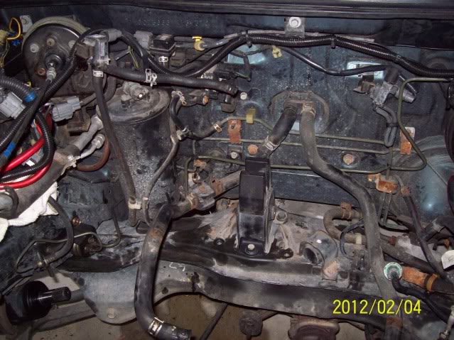

I was able to use the factory hard clutch line which saved me some money
Here is the Clutch Master mounted up
