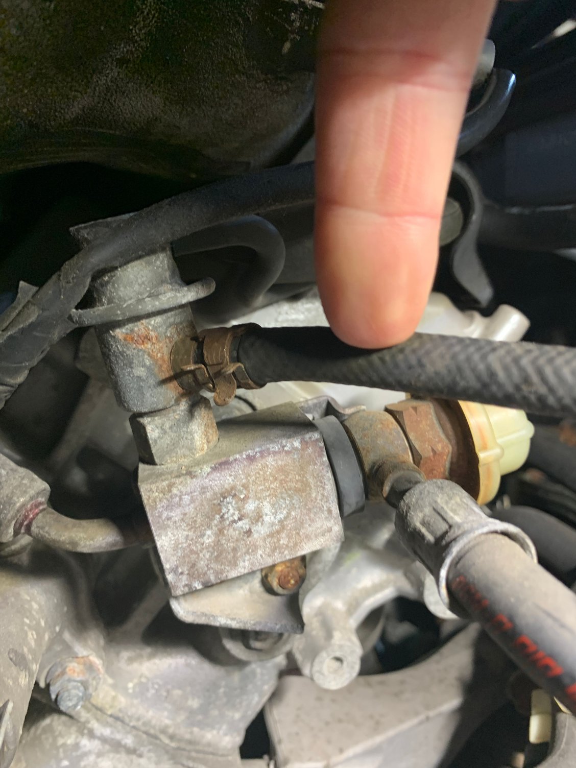

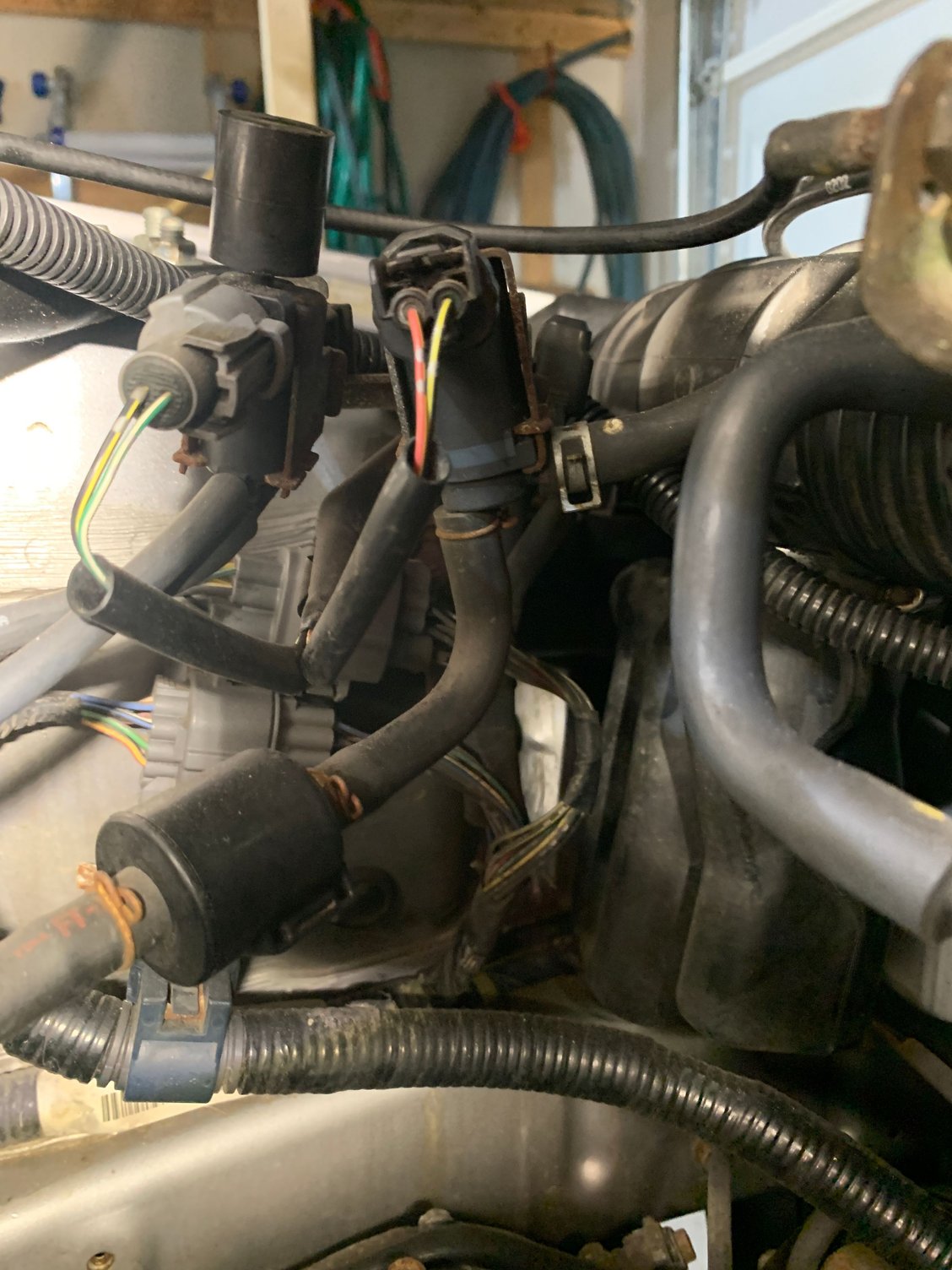

Old Feb 23, 2022 | 07:45 PM
Trevor C.'s Avatar
Joined: Jul 2021
Posts: 13
From: Cincinnati, Ohio
Here’s a couple of photos of the delivery and recovery hoses. The photo with my finger is the line where the fuel came out when I disconnected the line.
the other photo shows the other line. It has the large cylinder in the middle of the line.
does the look to be routed properly?
thanks so much for the help!
trevor
Old Feb 23, 2022 | 09:54 PM
Posts: 16,334
You are pointing at the fuel return line in pic #1. The fuel supply line is just below your finger in pic #1 with the banjo bolt. Disconnect both lines and turn the key to the II position. Let us know which line sprays fuel for about 2 seconds when the fuel pump primes.
Old Feb 24, 2022 | 06:39 PM
Trevor C.'s Avatar
Joined: Jul 2021
Posts: 13
Ok. The fuel is coming out of the line that my finger is touching in the photo.
with that being said, did I screw up and reverse the hoses when I ran the lines?
Old Feb 24, 2022 | 06:41 PM
Trevor C.'s Avatar
Joined: Jul 2021
Posts: 13
This is the line the fuel is coming out of.
