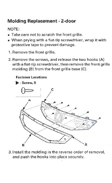

The service manual says to take off the top cover, then the bumper, etc. to replace the grille cover. The only reason it says to take off the bumper is to access the plastic clips holding the grille to the bumper.
On the sedans, people have been able to take off the plastic clips from the grille without removing the bumper. I am not sure if you can easily access all the clips holding the grille on the coupe, without taking off the bumper.
After the grille is removed, on the coupe, to remove the chrome molding there are 9 screws and two hooks that hold it on the grill.

Note that the chrome molding on the grille base for the coupe is attached differently than the sedan though. The coupe grille chrome molding is held on with 9 screws and two hooks, whereas the sedan is not. -- These instructions are not part of the Mugen grille instructions.

Here are fog light installation instructions for the 4 cylinder coupes, which shows bumper removal. Bumper removal for your V6 may be identical or similar. -- You may not need to remove the bumper if you can reach all the plastic clips holding the grill on.
http://www.collegehillshonda.com/ins.../foglights.pdf
The attached pic shows the chrome molding removal from the grille base after you removed the grill assembly from the bumper.
