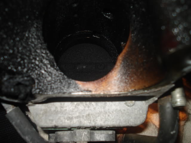

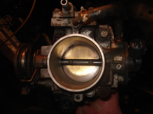

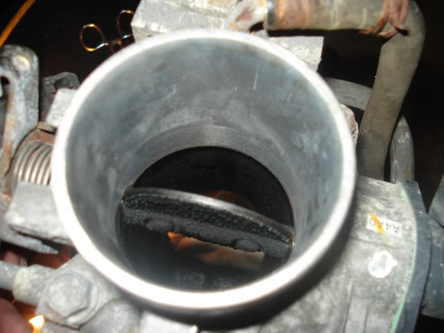

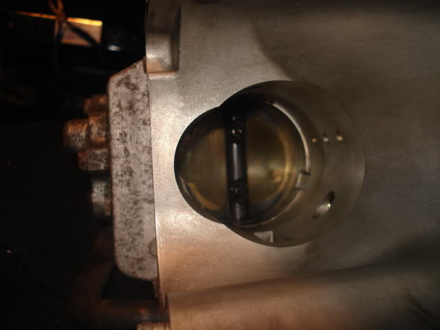

I just cleaned mine on saturday, so it's fresh in my mind.
To actually remove the sensor, it's a 5-point bit, not a Torx or anything, so I left it in there. To take the valve off youll need to loosen the 10mm bolts holding it to the manifold. And a good spray with carb cleaner, a nylon brush and a q-tip should clean it out pretty good. But, the problem probably lies in the port on the manifold itself. To find the bolts youll probably need a mechanics mirror (similar to a dentist mirror), but it may not even be accesible without taking the whole manifold off. I found the latter to be the easiest since the manifold is push farther back than the 95 I used to have.
I took the whole upper half of the manifold off over the weekend to thoroughly clean it.
Before:
After:
In the last picture, the IACV port is the slotted one on the bottom of the picture (side of the manifold if rotated correctly)

My engine had a slight surging idle, but nothing to worry about. When the car was started the idle also liked to dip down to 250 and then back up again, almost stalling. I'm driving to Florida from Minnesota on Friday so I wanted everything to be in top shape and I may have slight OCD, so I cleaned it haha.
Things to take note of:
- One of the vacuum hoses on the IAC is difficult to put back on and the manifold has to be angled a funny way to do it, it took me a while to get it back on and tight.
- Drain the coolant out of the radiator all the way to make sure there is no coolant sitting in the manifold (I don't even think there a coolant feed line going to the manifold, but I did what the book told me to.
- Take pictures of all sides of the manifold before you start just in case you forget where something connects to.
Here's every thing you have to unplug/disconnect:
- Ground wire (drivers side)
- Mounting bracket thing (drivers side)
- air intake piping (passegner side)
- IACV (blue connector, passenger side)
- Air temp sending unit (I think, driver side of manifold) (white connector)
- Manifold Absolute Pressure sensor (map) (gray connector, passenger side)
- 2 vacuum lines from top of manifold
- vacuum line under throttle body (you can see the nipple in the pic)
- vacuum line #9 from part #5
- metal vacuum bracket from fuel rail (I found it easiest to remove the tube from the bracket on the valve cover side of the bracket)
- PCV tube on manifold
Wow, that's a lot of stuff. If you decide to do it, good luck! I'd set aside a full day to do it, but it should only take 3-4 hours to remove, clean, and install it again.

I used CRC Thottle Body/Carb Cleaner
All I did was wipe it, spray it down, wipe it again, spray it, scrub it with a nylon brush, spray it, scrubs the stubborn spots with a brass wire brush and sprayed it down again.
