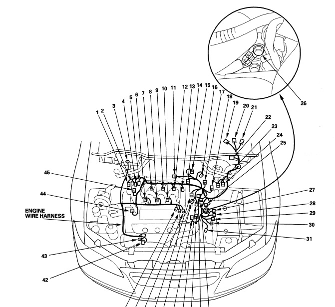

The issue could be the PCM is faulty and not sending the signal to shift at the right time.
I know you have a few threads going, but have you checked for codes?
Check that G101 (#26 in the attached picture) has a clean and secure connection. You may want to disconnect the battery, disconnect G101, clean the eyelet, bolt, etc. with a wire brush or sandpaper, the reconnect.

The bolt with grounds on thermostat housing?

Not as familiar with the V6, but I think they are on the thermostat housing.

thermo housing has a temp sensor too. which I believe is for the cooling fans. lots of info online about the G101 ground. I will check any and all grounds that I can find. interesting that pic has battery removed to show this view. maybe motor is on engine stand at Honda?
