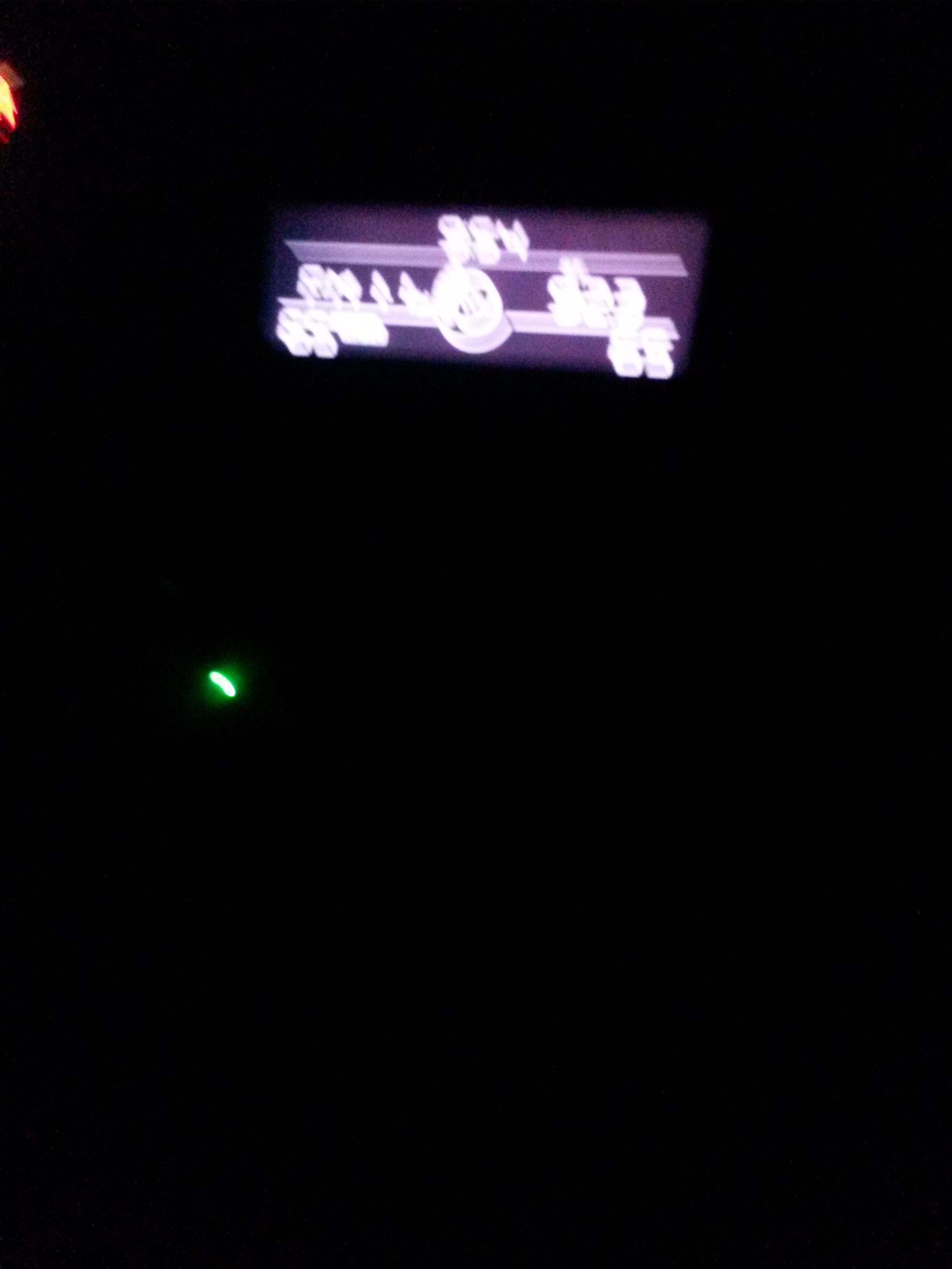

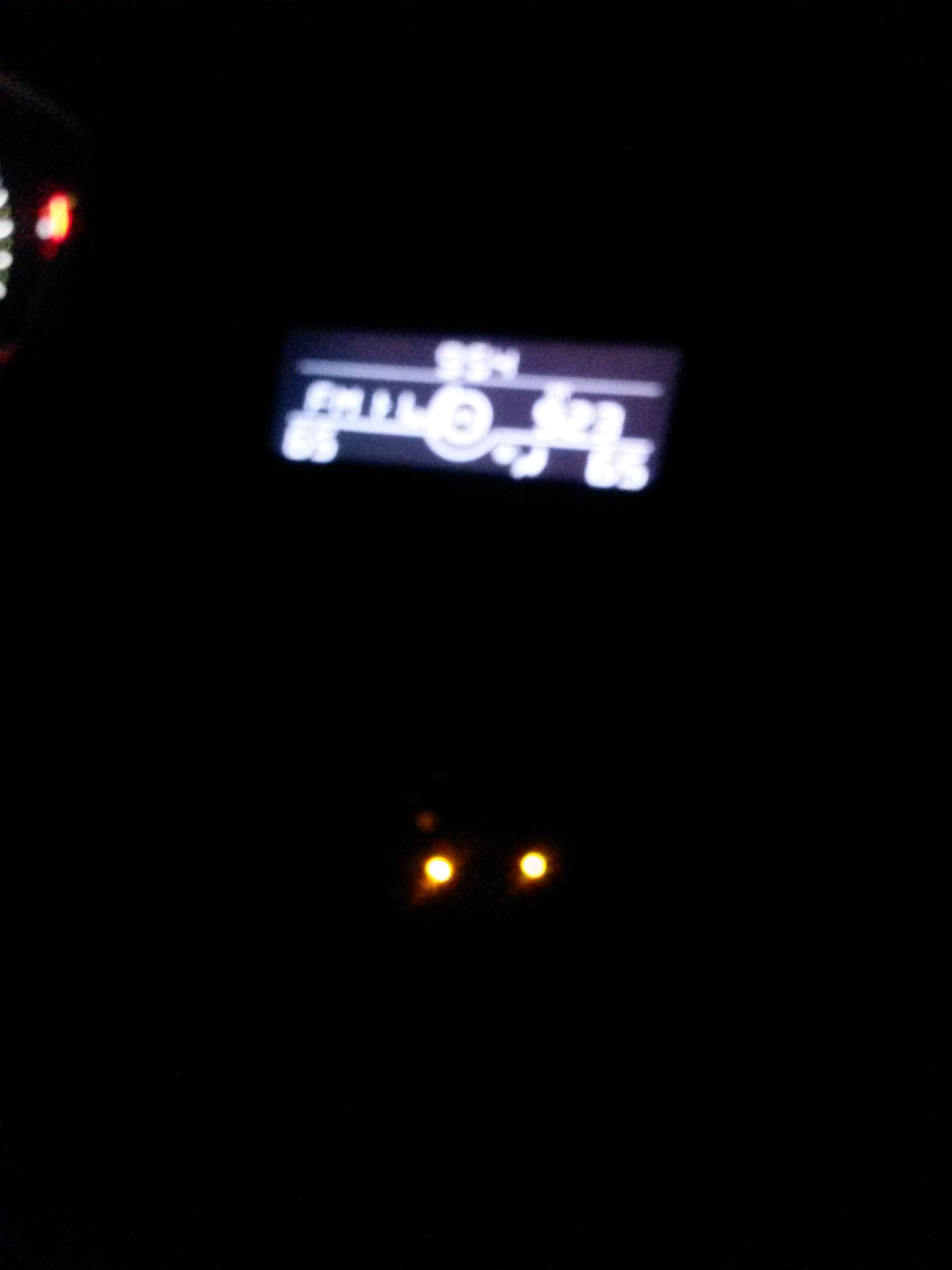

Also - took a photo http://imgur.com/ccyCGcn
http://imgur.com/lY8iXD3
