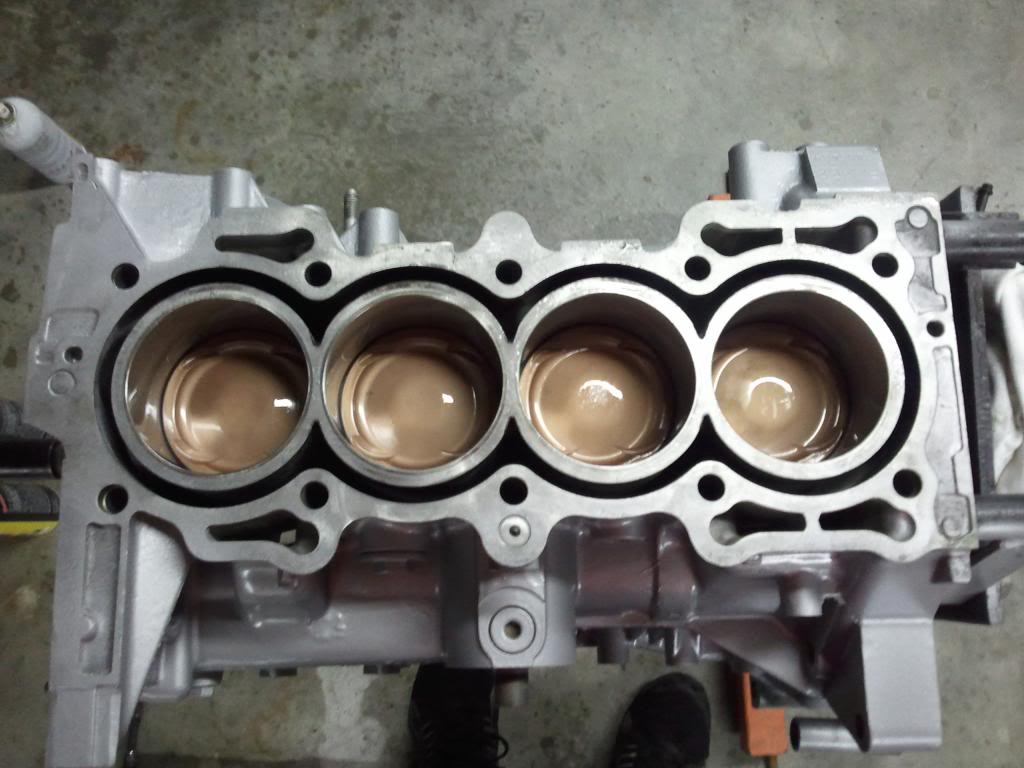

Mine leaked between at least a couple of cylinders; could hear it clearly when a cylinder was pressurized. Siamesed cylinders with not much meat between them.
OP: This has no bearing on your problem, if any.
