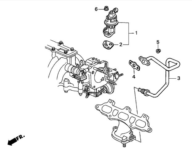

Old Aug 31, 2014 | 05:48 AM
  #17
Just adding the "egr tube" set up - it is much like my old 3rd gen's.......just too bad you can't buy a new tube for the old 3rd gen's
