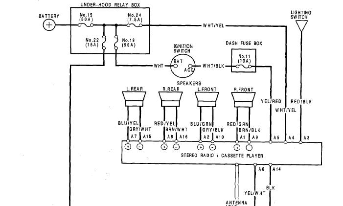

I'm confused, not hard to do and I haven't had the proper intake of coffee yet.
Car wires:
Power is from the YEL/RED wire-key on.
"Memory Power" is from the WHT/YEL
Headlight "Dim" or whatever is from the RED/BLK
Now how and where they go on an aftermarket system is a different story.

The YEL/RED or the RED/BLK.....I'm using the factory wires here.......before the "splice" that was done.
Old Feb 11, 2012 | 08:53 AM
Or let me try this a different way.
The RED wire that is power to the new radio should connect to the YEL/RED factory wire.
Sounds like when they "pulled it" the wire broke where it was "spliced" into the fatory wire.

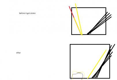

Okay, I guess I did confuse everyone with the red wire thing. It looks like its the yellow/red wire from the original stereo. this is a diagram I drew on paint.
As you can see, the square is the hole where the stereo goes and the lines coming out are the lines connected to the car that were connected to the originial stereo. I drew them black because I didn't want to use every color. The yellow just looked pretty so I put it in there. The red/yellow is the one I am talking about. It is the one connected to the power supply. As you can see, it is in the before picture, but not in after. I tried sticking my hand inside the hole and I can't feel where the wire would be.
