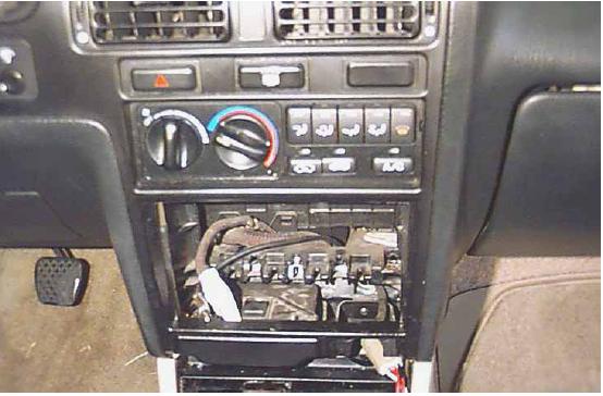

Got a digital camera?
Can you reach back far enough on the wires to get to the factory "bundle".....they should be taped together or inside of a cover. In that "bundle"/harness are all of the wires to and from the radio....in that bundle will be the YEL/RED wire....
In the pic you can see the factory plug (white rectangle) then the bundle of wires. If you can't get your hand in there you might have to remove the trim pieces around the radio to get back to the factory harness.

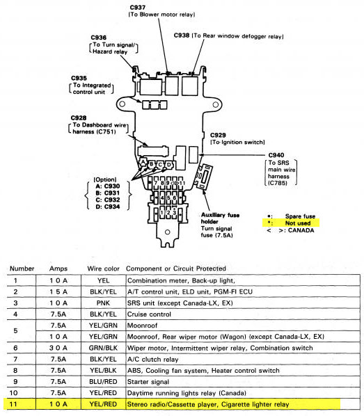

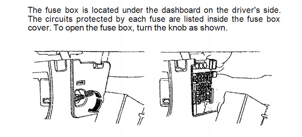

Old Feb 12, 2012 | 10:55 AM
You can add the fusible link to where the existing stereo fuse plugs in or pick another fuse location. On many Hondas, the diagram which shows "not used" can be use to add accessories. I would use tie-wraps to secure the new wire extension while routing it.
