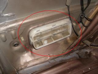

Ok, I have found that the source of my trunk leak is this vent thingamajigger on the left side of the trunk in my '91. It leaks from around the perimeter of it. My question is how do I get to it to seal it? Am I right to assume I have to remove the bumper to get access to it?

Is it leaking into the trunk from there? Or is the antenna, going on memory that is the side it is on, leaking and looks like, puddling around that area. The outside area of the vent, isn't a place where I think water would "come into" the trunk....trust me I really hate water leaks. have you used "baby powder" or some other method of confirming that is the source. If that is the source, why remove it, just seal the inside part. If it had a sun/moon roof then I would offer another suggestion.

Yeah, I had the garden hose running on the fender above the bumper "seam" and below the antenna and it leaked in around the edges of the vent. The thing looks like it was pushed in from the outside on the assembly line. Maybe there is a small flange on the outside, hidden from view when looking at it from the trunk? Thought that to seal it best, I should remove the vent and caulk it from the outside...
Old Nov 18, 2010 | 10:21 AM
Air outlet (#26) installs from the outside. There's probably a gasket kinda like the tail-lamp assemblies have gaskets. Taillamp gaskets leak too...
Since it sticks into the trunk space, you probably CAN caulk it from inside the trunk. Not sure how much pain it involved in removing the bumper.

Not leaking from taillight lenses...I have replaced all four and tested...it does leak from the vent.
