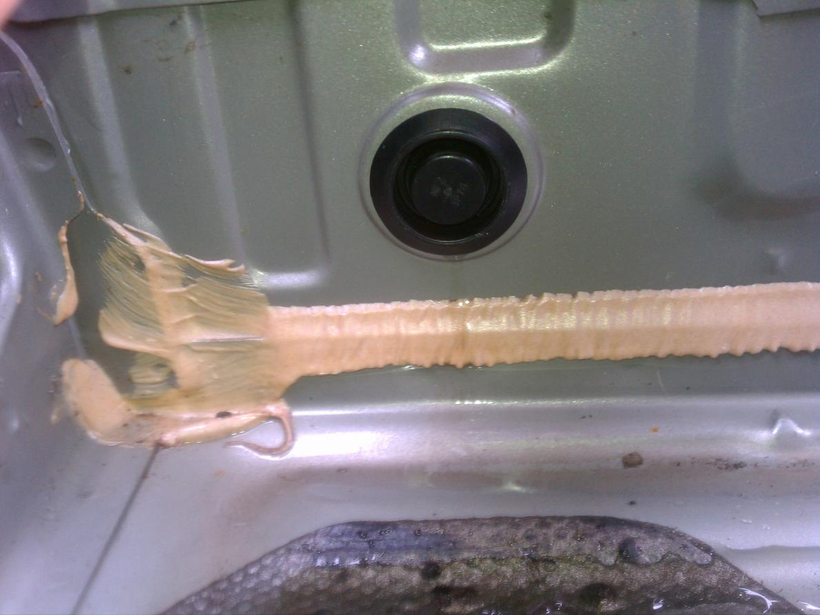

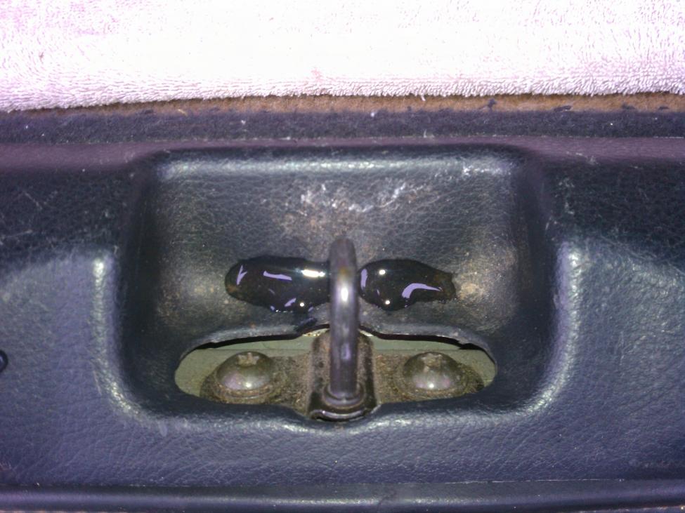

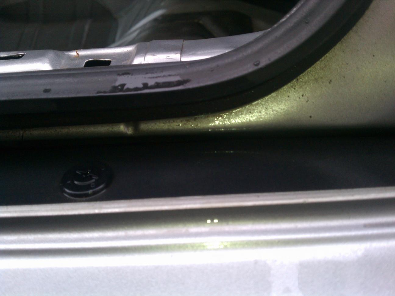

Default Replaced Seals-- Still a leak.
So I ordered new outer seals from Honda, pulled the tail lights out, and replaced them. However the trunk is now leaking from a black plug located on the back of the trunk. I had someone spray the seam between the bumper and trunk and water leaks from the plug. Pictures are attached showing the plug and where I spray water. Do any of you know why the holes are there? If I order a new plug, do you think that will fix it? Additionally, water has been collecting in the trunk latch plastic. What else could leak and cause that problem?

Not sure why the hole is there, but a couple possibilities...
For trailer-light wiring, you replace that with a grommet for the wires?
For alignment fixtures when they're assembling the body?
You ought to be able to seal around that plug with some caulking.

Dude! Just fixed this problem with lacer thinner to clean and silicone all the way around the perimeter of that box and over the white clips around it. I let that sit for a day then had my son hit the trunk with the hose from all angles and found it to be as dry as a popcorn fart.. That is my 92, but my 91 has a leak around the taillights. new gasket is on my list.

I replaced these 2 plugs and they don't leak anymore.
