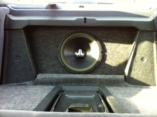

The Parts Express carpet was a pretty darn good match. See attached picture of the new box. It's a sealed 1.25 cu ft box. You'll note that the trunk carpet is actually a bit darker than the seat-back material. The trunk side is a great match - which is what I wanted.
The JL sub is rather old and is temporary. You have to love the faded surround - this thing just keeps thumping... The new sub should be going in shortly.

old JL subs sound nice. I still have some Hollywood Sound Labs 12" that were basically JL W4 with different colors. they still work great and i bought them in 1996.
that looks nice. ensure you have a good seal between the front of the sub box and the trunk opening - as airtight as possible for the most bass in the cabin.
again, nice job. i really liked that configuration when i had it. smooth and accurate bass that wasn't overly boomy.

Thanks! Where do you think I got the idea? I was copying parts of your install. I did this in another car as well with an old-school kicker competition sub and LOVED how it sounded. I always received complements on that setup - and finally sold it to a friend who wanted it in his car.
I'm sealed real well on the sides and bottom - but there is a gap along the top. Do you think I'll hear/feel any noticeable difference if I seal that up?
Yeah, this sub sold me on JL stuff. But, I pulled it out last night - this box was just too big for it. I'm honestly not sure which model it is - other than it's a 4 ohm 12" single voice coil from the 90's. It was a little boomy in a .8 cu ft box, and sloppy in this 1.25 cu ft box. I'm thinking 1.0 would be perfect for it.
