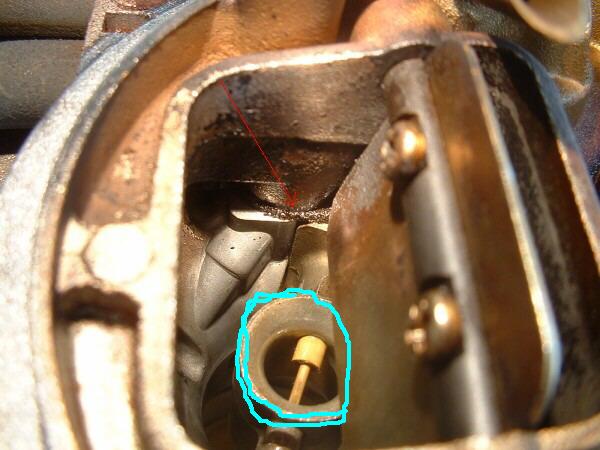

Ok, here are a few things we can try.....I really want to help as I like the 3rd gen (86-89) Accords.
If you remove the top of the air cleaner, like you were going to replace the air filter. A few "snap clamps" and two wing nuts. Once the top is off, there should be a gold color screen over the "throat" of the carb. There are two 10mm nuts holding that screen on.
Remove those nuts - don't drop them into the carb. Start the car an look down the "throat" of the carb - can you see any gas dripping? This pic has some areas highlighted that you need to look at. Also be sure the "flap"/butterfly is opening once the car starts to get warm.
When the car does die, does it start back up? Or do you have to wait some period of time?
Do you smell gas?
Also there are two fuel filters on this car, have they been replaced? One is easy, under the hood right by the brake booster/master cyl.
The other is at the rear of the car. Best to jack up the car and remove the left/drivers side rear tire to get to it.....I can give more details if needed.

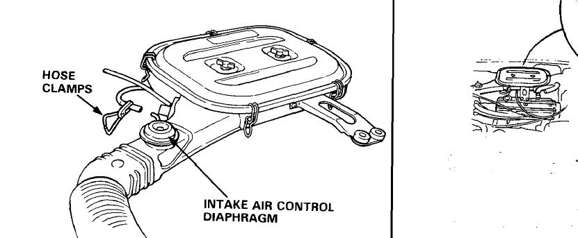

If the car sat for a period of time then this could just be "bad gas". Which the seafoam will help with.....best thing is to fill it with fresh gas and a bit more seafoam (or something). At some point you do want to change to the two fuel filters.
The one under the hood is easy, if you get stuck with the one in the rear let us know and we can help.
Also, just for reference....here is a pic of the air cleaner.
