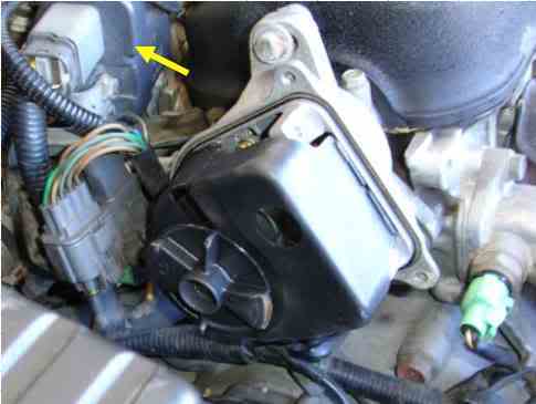

Well, my wife is still not home, but I remembered that I photographed the dist in my timing belt post.
I'm pretty sure that's thecoil that the yellow arrow is pointing to.
Because the coil is external to the distributor, I'm not at all sure the ignition module is in there, either, even though it sure seemslike it should be there.
So ......... is the igniter inside the distributor on this external-coil type of distributor?

ORIGINAL: Tony1M
Ignitor is inside the distributor, remove the rotor, remove the cover and Voila' there is is ,, it has 4 wires going to it
