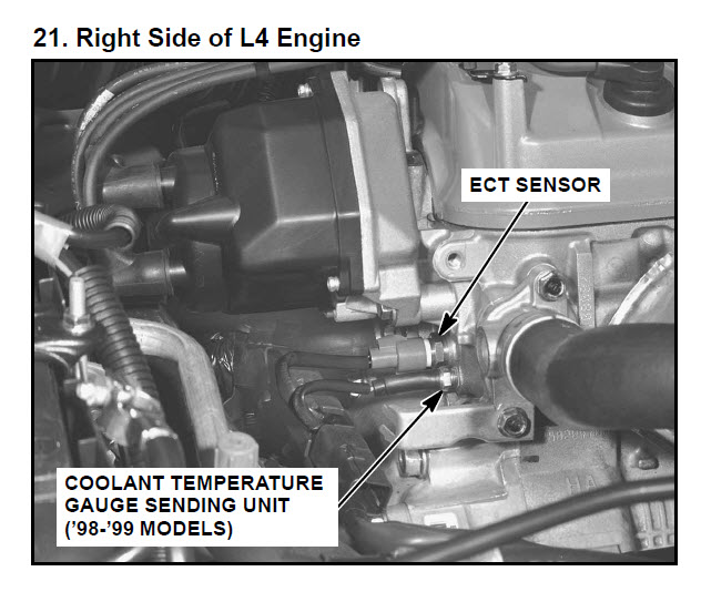

For your 99, the coolant temperature sending unit controls the temp gauge . See pic.
Check to make sure your heater hose does not have a leak. IIRC, one end of the hose connects under the area of the distributor.
The radiator fan switch is a normally open type of switch, when the coolant temperature is above 199 degrees F, it should close to turn on the fans. Disconnect the connector at the radiator fan switch and jump the connector with a wire or small paper clip, turn the car to ON, does the fans run?
Feel the lower radiator hose to see if it get almost as hot as the upper radiator hose. If it is, then the thermostat has opened.
Attached Thumbnails Strange overheating problem - 99 EX 2.3 auto-coolant-temp-sending-unit.jpg

I jumped the radiator fan switch connector with a paper clip, turned the car on, and both fans turned on.
I checked the lower radiator hose and it took a while but it finally warmed up significantly. I believe the new OEM thermostat is working fine.
The only time I could detect a leak in that area is when the car overheated and it was dripping on I believe the heater hose and then evaporating and causing the smoke. I have not seen a leak when it has not overheated in this area.
