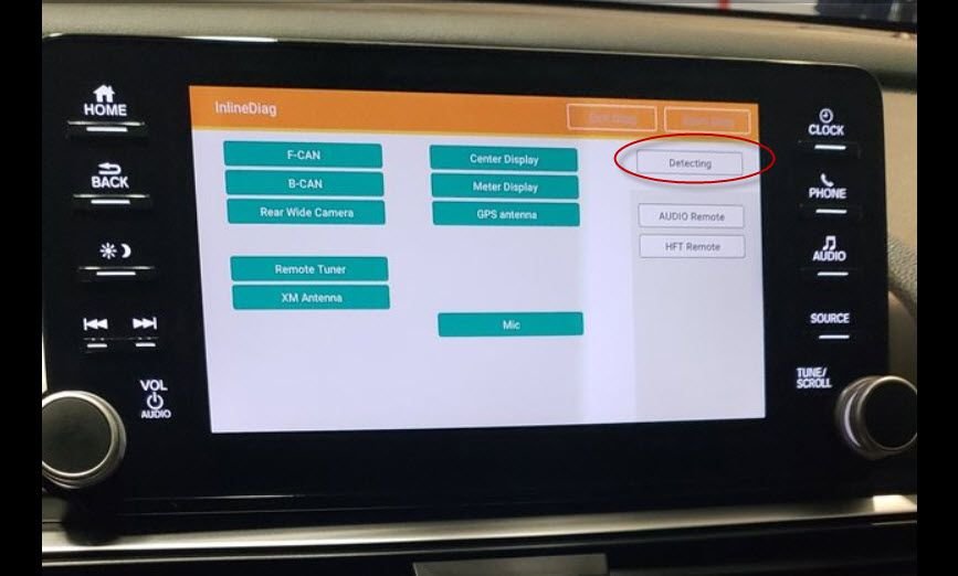

Hi All,
The head unit on my 2018 Honda Accord EX stuck in InLineDiag mode. This happed after I reconnected battery terminals after installing a new powered sub. Clicking on "Exit Diag" button does nothing, seems like it is disabled. Any Idea how to exit this mode?
Inlinediag screen I stuck with

Old Dec 12, 2020 | 06:28 PM
When the diagnosis is in progress, the icon (circled) will indicate "Detecting"
To force completion of the In Line Diag and Linking:
Follow these steps to prevent the screen from appearing in the future:
1. While displaying the In Line Diag screen, press and hold the HOME button, the SOURCE button, and the AUDIO POWER () button until the Select Diagnosis Items menu screen is displayed.
2. While displaying the Select Diagnosis Items menu screen, press and hold the HOME button until the InLine Diag setting screen is displayed.
3. Set the Inline Diag Setting to OK (complete). The system restarts and a normal start-up process occurs. The In Line Diag should not appear again.
