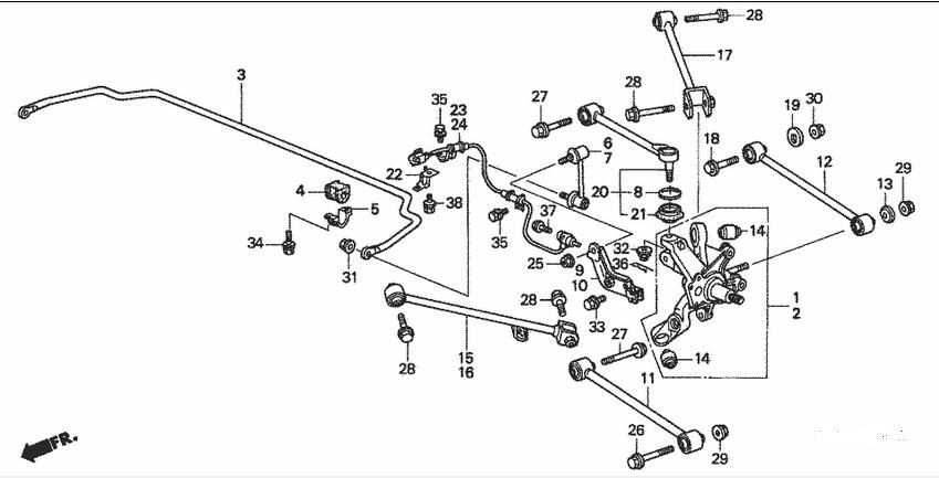

Nope, not the bushing bracket itself, but the formed metal piece that the bracket bolts to and is in turn welded to the subframe. It basically goes right under the inner end of the trailing arm.
Old Oct 15, 2016 | 05:34 AM
I'm not following you on this one?
The rear beam can be replaced and so can the items that are mounted to it.

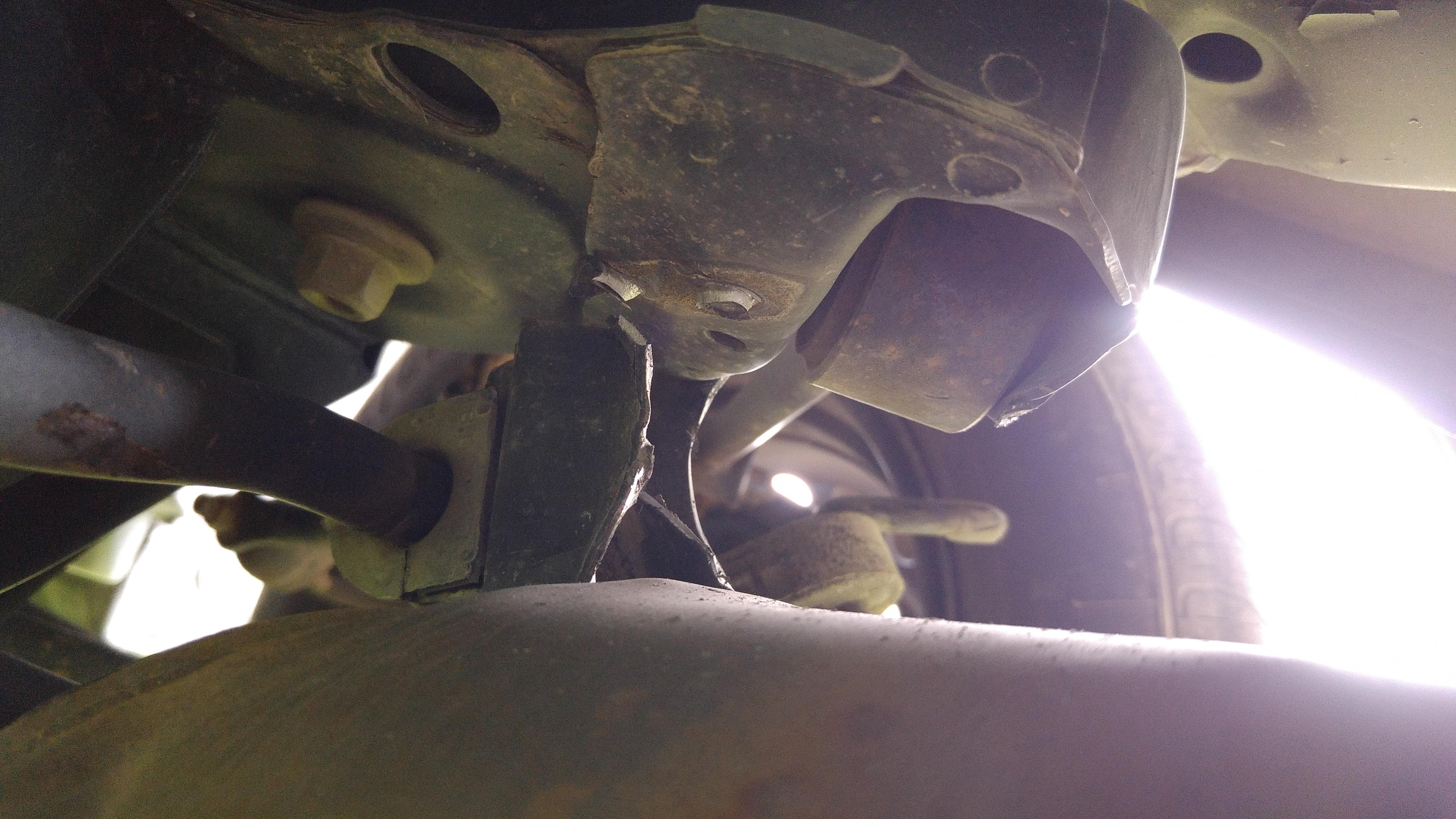

I think I answered my own question. The part in question is completely torn off the subframe and cannot be obtained separately (see attached pic).

It looks like you have the mounting bracket, but it's broke loose from the rear subframe. You should be able to rotate it 90 degrees (so the bolts and bushing clip point straight down), and re-weld it into place.
