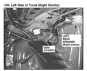

On your coupe, visually check the wiring and connector at Connector C554, located at the left side of the trunk.
Attached Thumbnails Tail Lights staying on?-fuse-box.jpg   Tail Lights staying on?-c554.jpg

Ok, the red/black wire inside the fuse panel does not have power when the switch is off. It does when the switch is turned on.
The plug in the trunk looks fine. Nothing appears to be shorted or anything. Which wires should have power at that plug?
