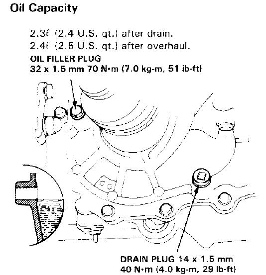

Too funny, I'm about the change the manual trans fluid in my 89 LXi this weekend
Use 10w-40 motor oil, it will take ~2.5 quarts (book says 2.3 at change). There is the drain plug, 3/8 ratchet into the square hole of the plug.....this lets the fluid out. Wipe it off, you have to decide on a new washer for the drain plug. Install drain plug.
To fill. Car has to be on level ground. You'll have to get creative on the fill hose. From the pass side fender, look where the pass side cv shaft comes out/meets the trans (might remove the intake tube for a better view).....slightly to the rear and above the inner cv joint there is the "fill plug". A 17 or 19 mm socket - there is a "split" in this gen that I can't remember right now- to remove the fill plug.
You fill the trans - slowly after 2 qts - until it starts to run out of the fill plug. Once it does....install the fill plug.
Edit: here is a pic that might help
