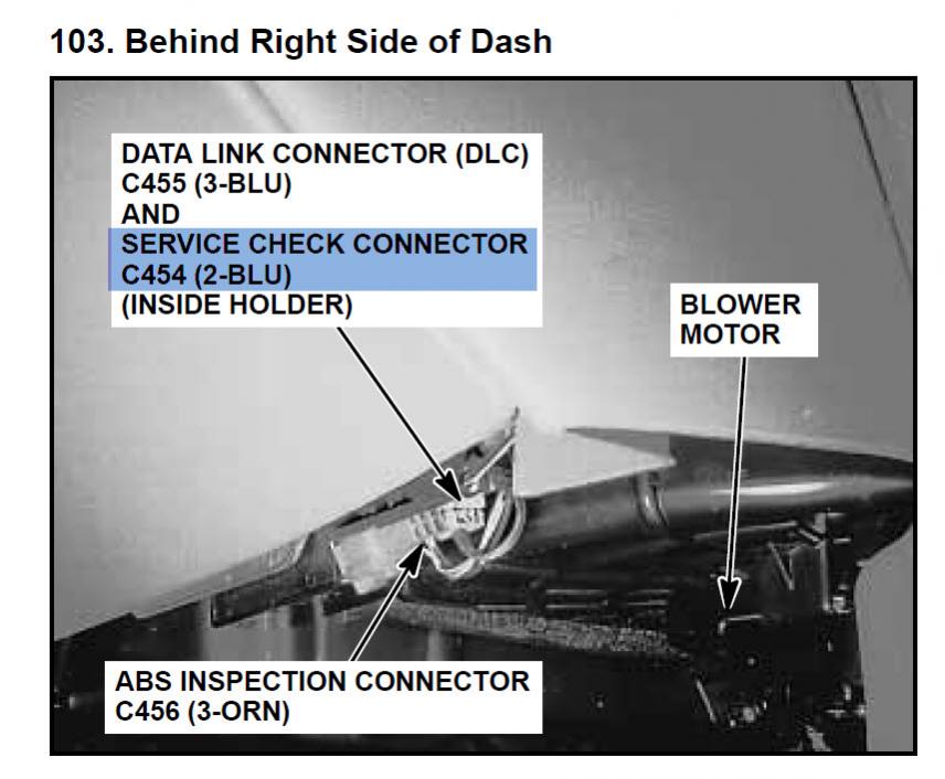

Underneath the passenger side glove box area are two blue connector (in a holder).
Unplug the 2P blue connector (Service Check Connector) from the holder. The connector has a red wire and a grn/blu wire. Then connect a jumper wire into this connector's cavity terminals. Turn the ignition ON and count the number of flashes. There may be either short of long flashes of the Check Engine Light, or a combination of short and long flashes. These flashes are to indicate specific trouble code numbers.
There is a sticky at the top of this forum section, "Common DIY and other info. thread" if you need more info. on counting the flashes.
