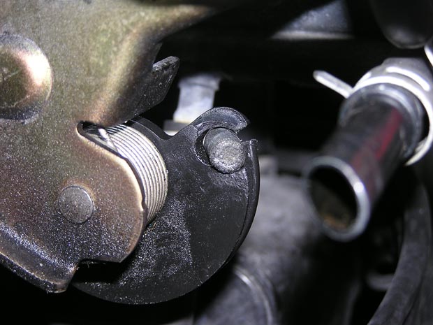

Also, as I was trying to determine where the t-stat house I rotated the cable assembly pulley on the throttle body closest to the air filter housing. The next thing I know I have a loose cable. I place the cable back in its slot but notice it is not seating correctly. After examining the assembly I see a peace of the pulley face is broken off. Is this plastic piece available separately? What is its function?

I suspect you'll need a new bracket w/ throttle pulley mechanism. I doubt the part missing is separately available. Try car-part.com for a part near your zipcode, and expect to have to buy the entire throttle body to get the throttle cable sheave. It'll still be a lot cheaper than a new assy from Honda.

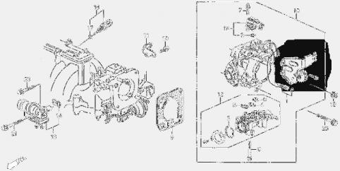

Thanks for the website Texashonda. I was able to locate a local place that had a used throttle body for an Accord V6. The piece I need is highlighted in the drawing. They want $150.00 for the throttle body.
Jim-Thanks for the pic. There's a spark plug cable bracket that has to be removed and a conduit of cable that partially blocks the view. I'll have to see if I can get to it this weekend.

I would discuss the price w/ your salvage yard, and point out that you can buy one and have shipped for $75 or less. I think a fair local price would be $75-100. I would mail order before paying $150. I've done this several times w/o problems.

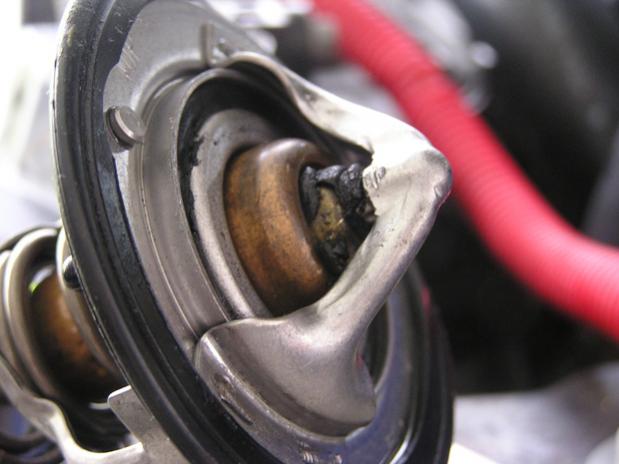

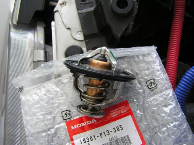

I finally got around to changing out my thermostat on my V6. I only had to remove the bracket holding the spark plug cables and wire harness. I also found it easier to access the t-stat housing by removing the battery and its shroud.
The old thermostat had most of the rubber on the top missing (see pic) compared to the new t-stat (see pic) and the rubber seal on the back (no pic) was hard and flaking off. I put in the new $25.00 Honda t-stat and the car runs much better then before.
