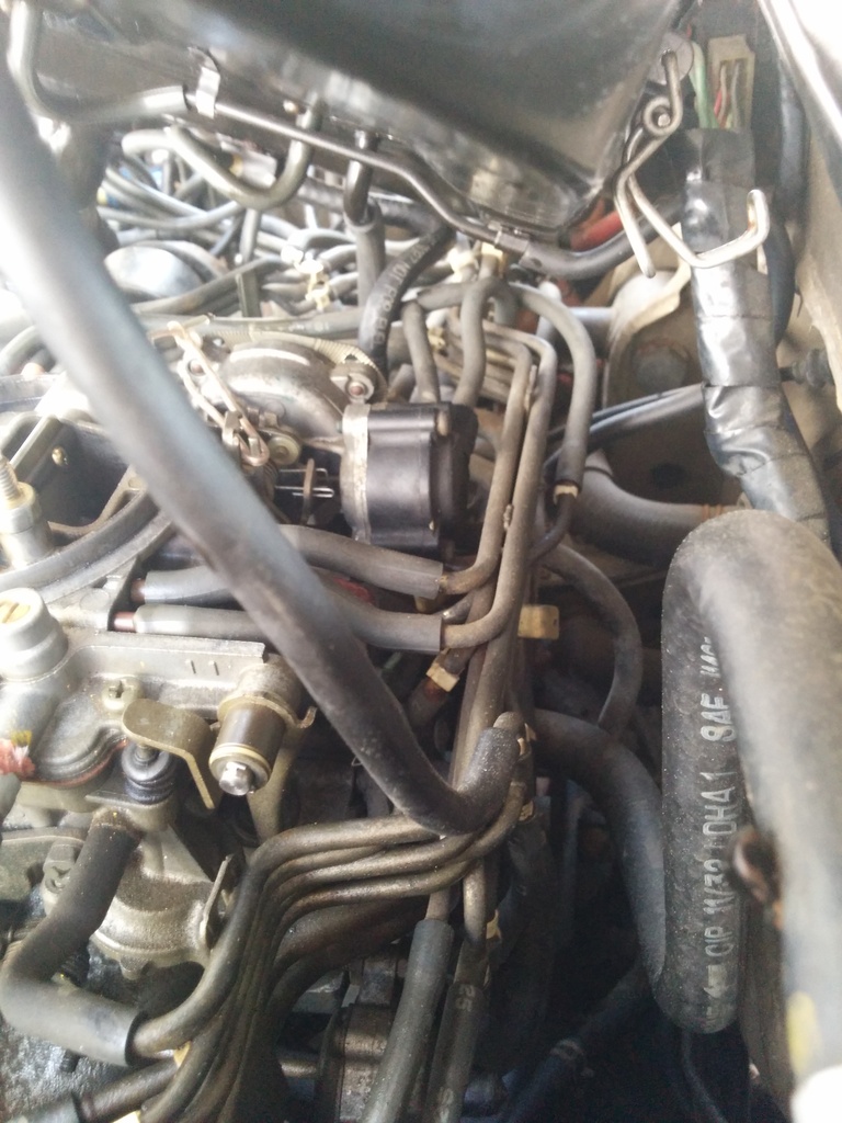

Inspect the vac lines and replace only those that are broken. Hint, pull the air cleaner base, at the back of the carb (carb to firewall), find the #7 vac hose and be sure it is attached to the base of the carb - use a screwdriver or something and give is slight tug to be sure it isn't burned thru right at the base of the carb. Other than that, enjoy the rife.

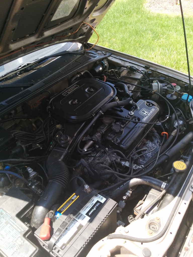

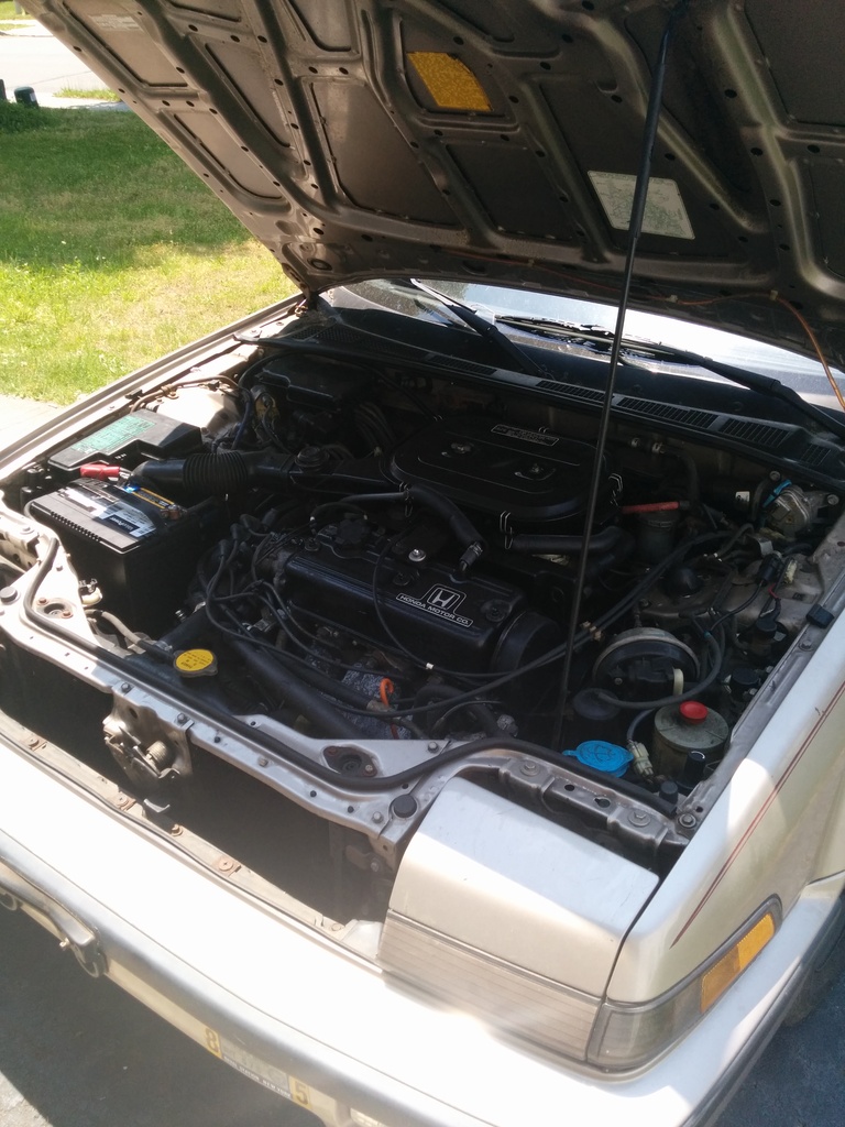

Ok guys, thank you for the tips, pictures are here as requested. A few other problems I noticed:

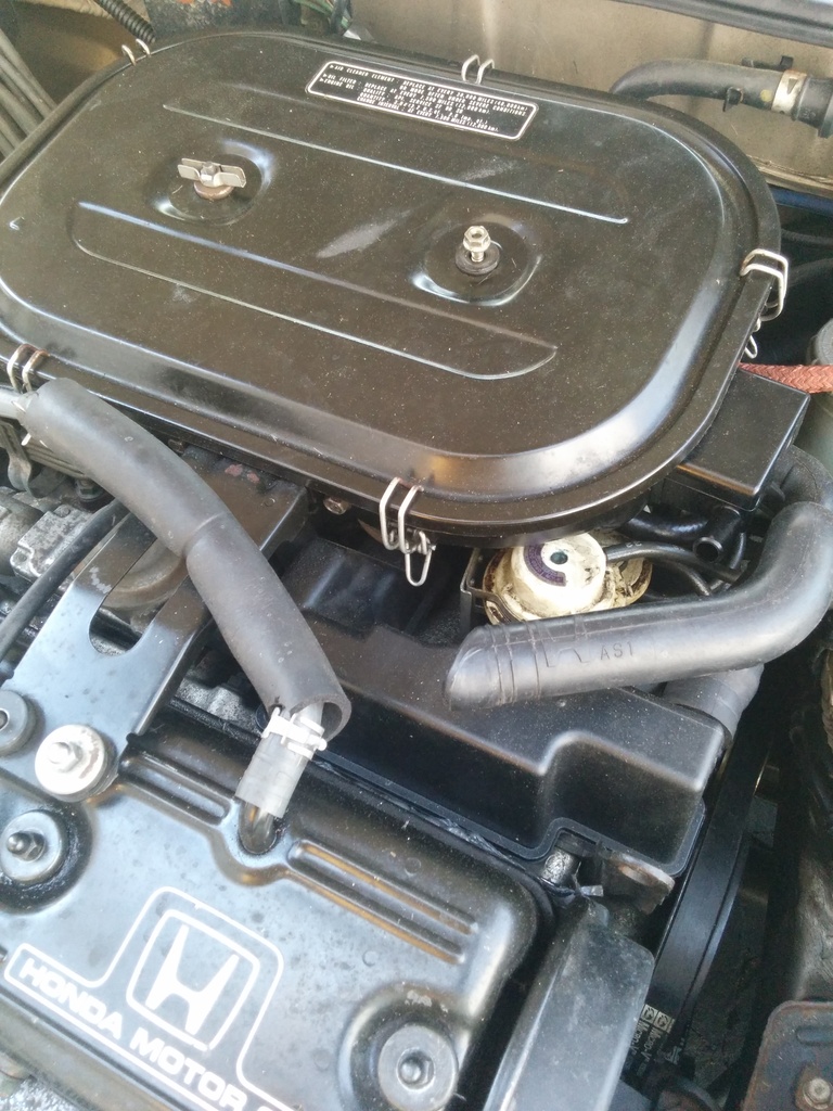

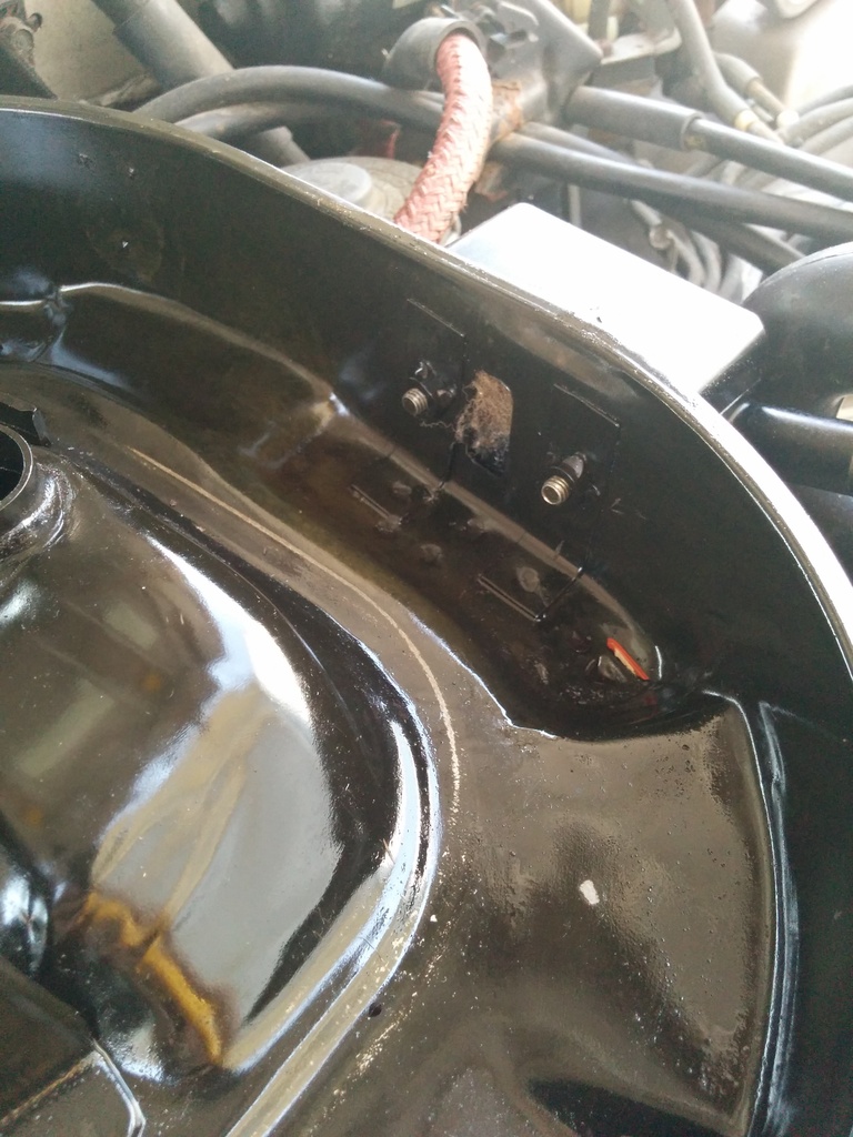

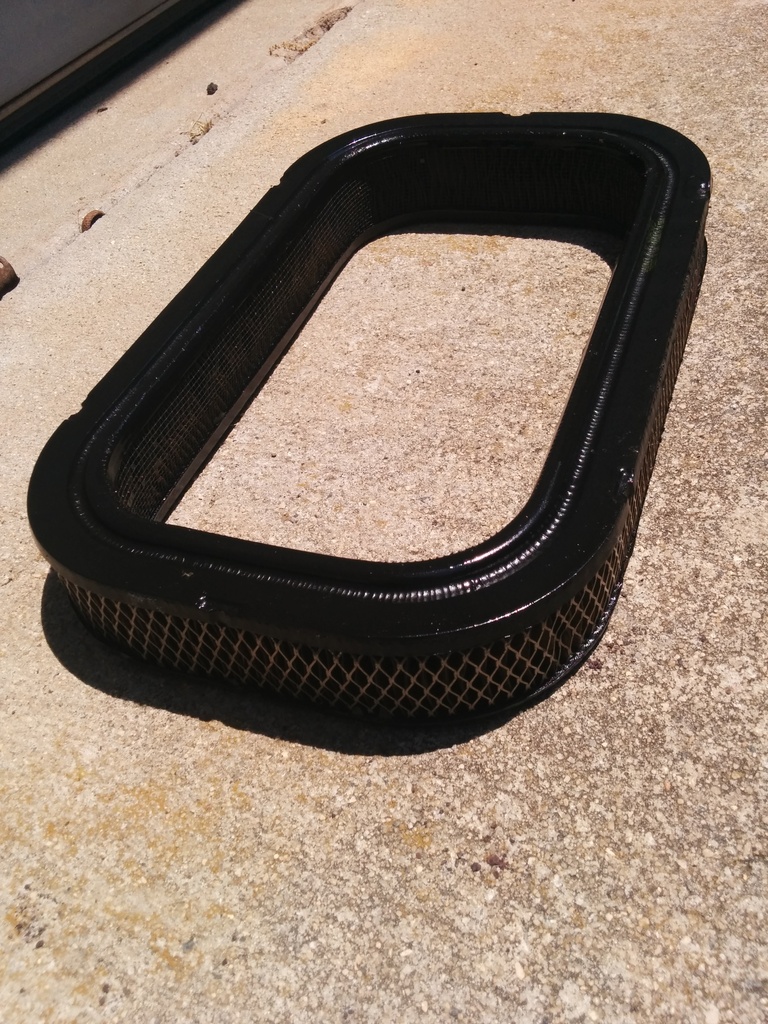

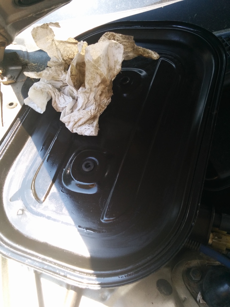

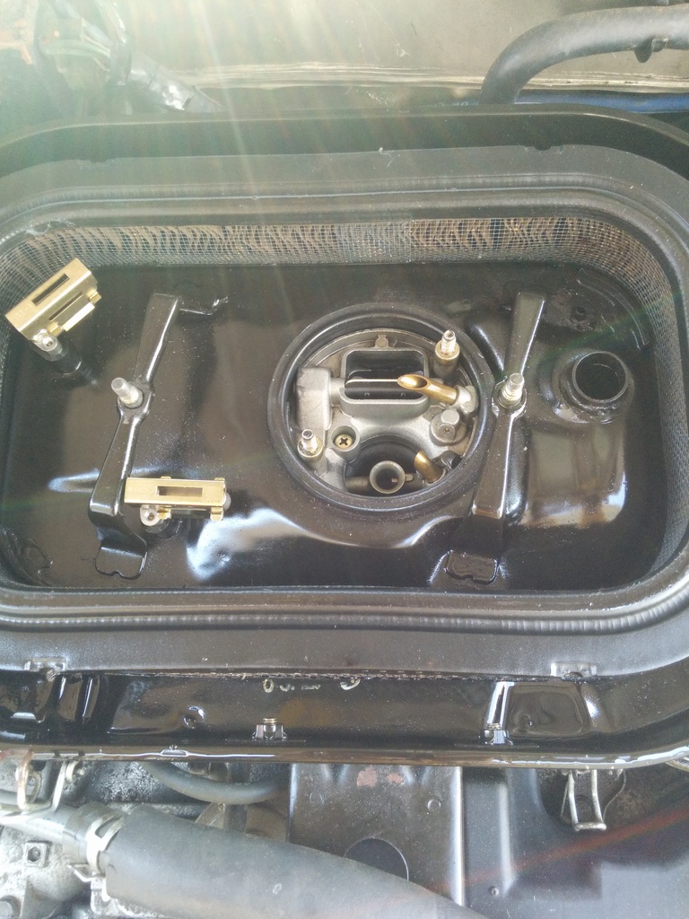

1) Inside the air filter part there was a lot of oil (?) The air filter looks soaked. I have a new one on the way and I tried to clean up what I could. Where would a leak be for this problem to happen?

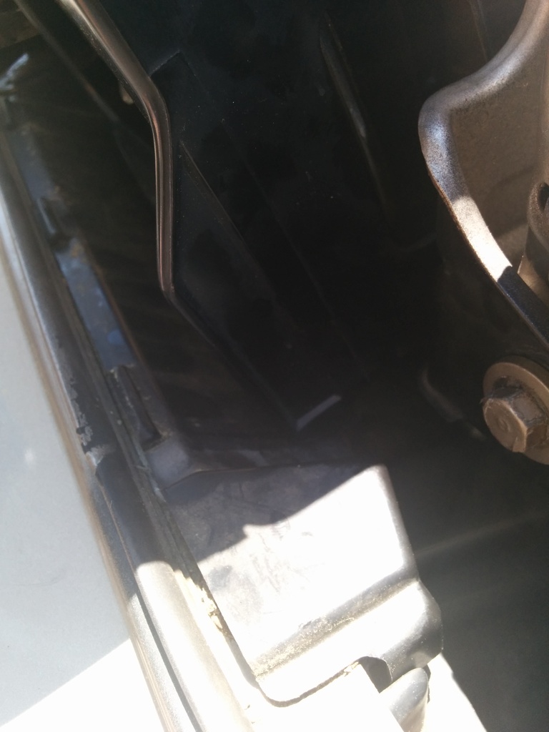

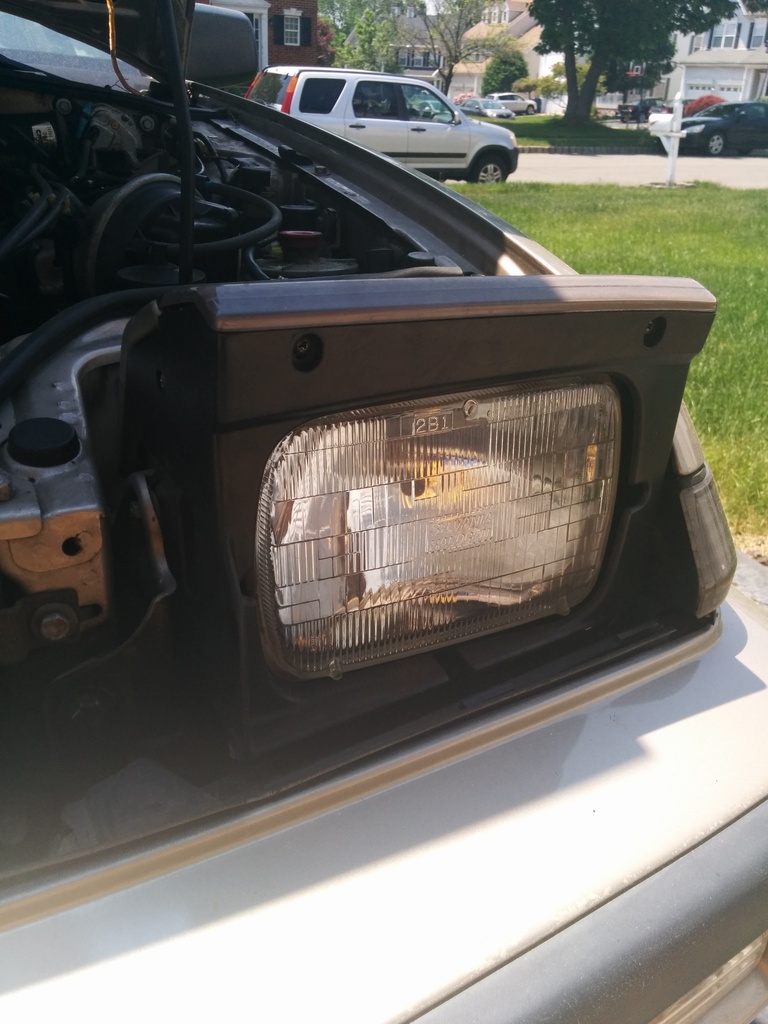

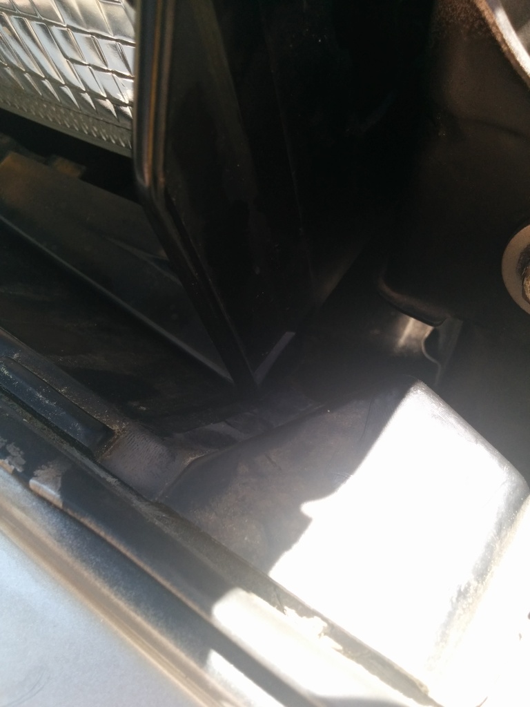

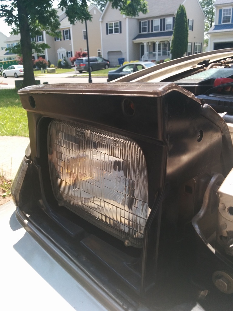

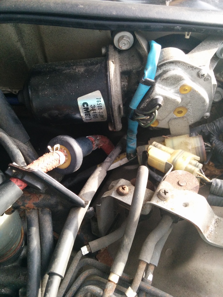

2) The passenger side light has trouble going down (just turned it manually with the **** - I think I will have to fix the electronic part later for both lights). IT seems like the plastic around the headlight comes out a little too far. I guess I will have to take the while thing apart to find out why.

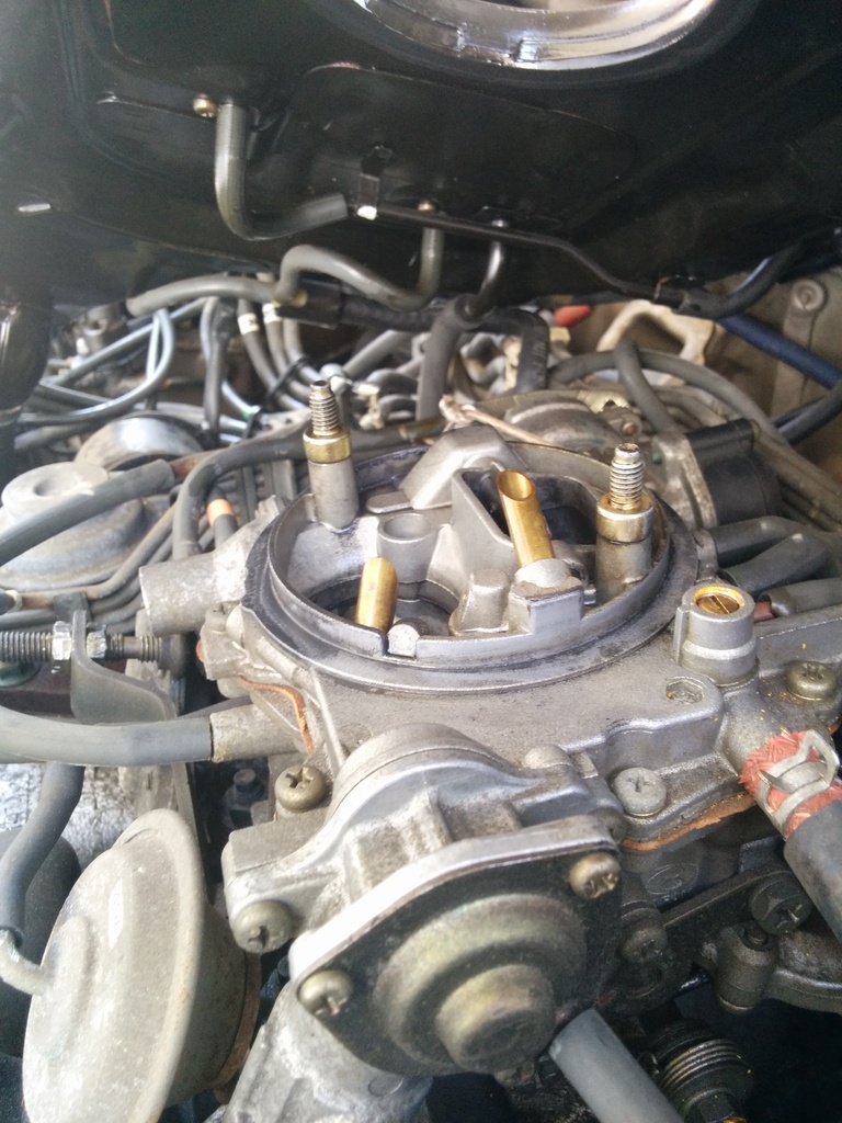

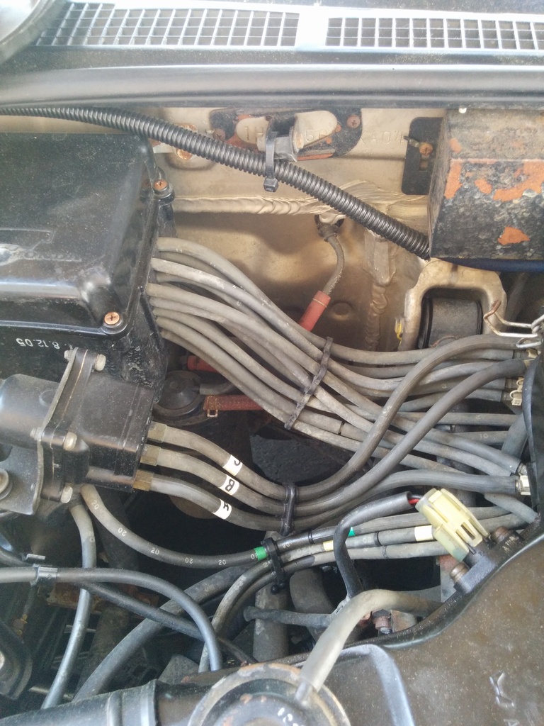

The choke plate was open when I took it apart, but I don't know if there that will change when I try to start it. The vac lines look to be in good condition to me, but there are a very large amount coming out of the back of the carb so maybe I missed one. I did not take the air filter housing all the way off because there were some small vac lines to the left that I was not sure I would know how to put back yet!

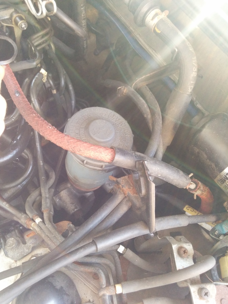

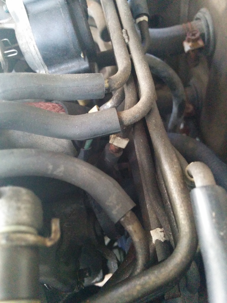

Someone has removed the "secondary" fuel filter. In one of the pic's I would see the fuel line and there is a "splice/tube" inserted where the filter goes.

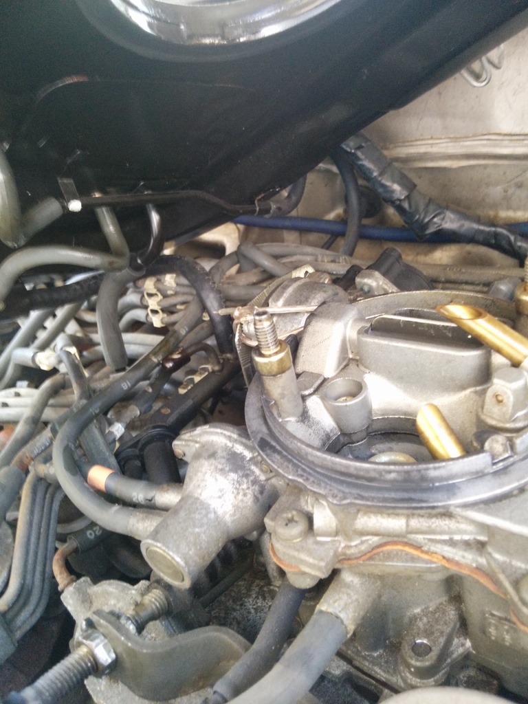

Again, on two of my 3rd gen carb'd cars, the #7 vac line on the back side of the carb -at the base of the carb between the carb and firewall - burned through. I can see most of the lines still have the "factory numbering" on them....notice the white numbers that are printed on the vac lines.....there are also plastic tabs at the "barbs" of the hard lines with numbers on them.....with a light look at the back side of the carb and see if you can locate a line with the "number seven" printed on it. That is the one I would inspect the most....leave the others alone.

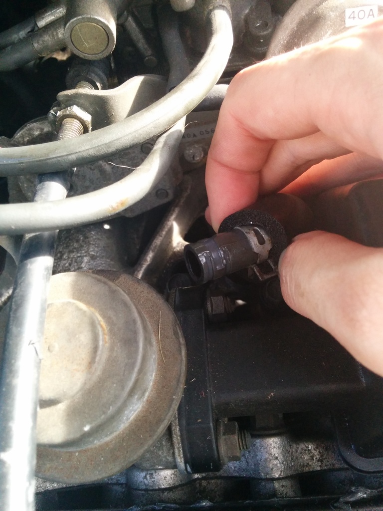

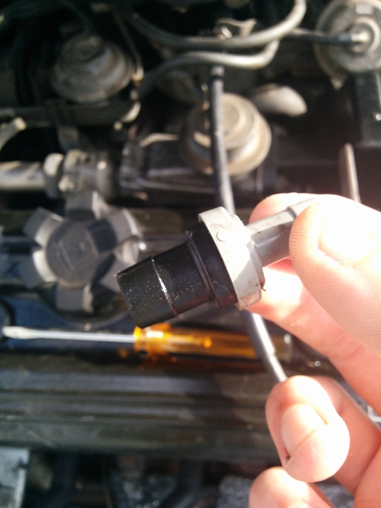

You might think about replacing the PCV on the car as well.
Thanks for the idea. I will check the #7 later today.

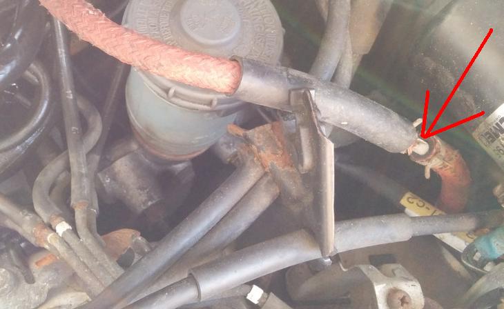

Should I splice in the secondary filter on the red-colored line? Maybe using some hose clamps? I have the replacement PCV on the way as well. Hopefully that would help with the oil issue...
The filter goes where the arrow is in your picture that I edited.
When replacing the PCV, be careful of the tube it is seated in....with age that tube can get very hard, the rubber turns into more of a plastic material and will break if you are not careful. Honestly, if you bust it let me know as I have the tube.....don't ask. OE part number 11856-PH2-000. Since I don't have a "carb'd" 3rd gen anymore it is doing nothing but collecting dust. The 89 I have is FI and has a different set up for the PCV.

2) Took out the PCV without any cracking problem that I noticed, but just to be sure I was doing it right, all I did was start to take off the hose clamp from the top of the PCV, and the bottom of the PCV slipped out of it's hole. What exactly secures the bottom of the PCV? It felt like it just came out without much force at all from the bottom. (From the top, where it connects to the breather hose, it was a bit difficult and took a while but the hose did not break) Anyway, 'bad' news: the PCV made the clicking noise fine when I shook it, so I guess that can not be the issue causing the oil leak? I am replacing it anyway but I am not sure where to look next. I am willing to try most anything if the tools are not too expensive.
3) Related: it looks like the previous owner did something funky (heh, not the first time now). There is a hose going from the top of the valve cover (upper right from the front of the car) That just goes down to the bottom of the car; open to the air. I am going to assume the worst that this was some kind of 'solution' to oil coming out of there, but I could be wrong. Does anyone know where this hose is supposed to be connected to?

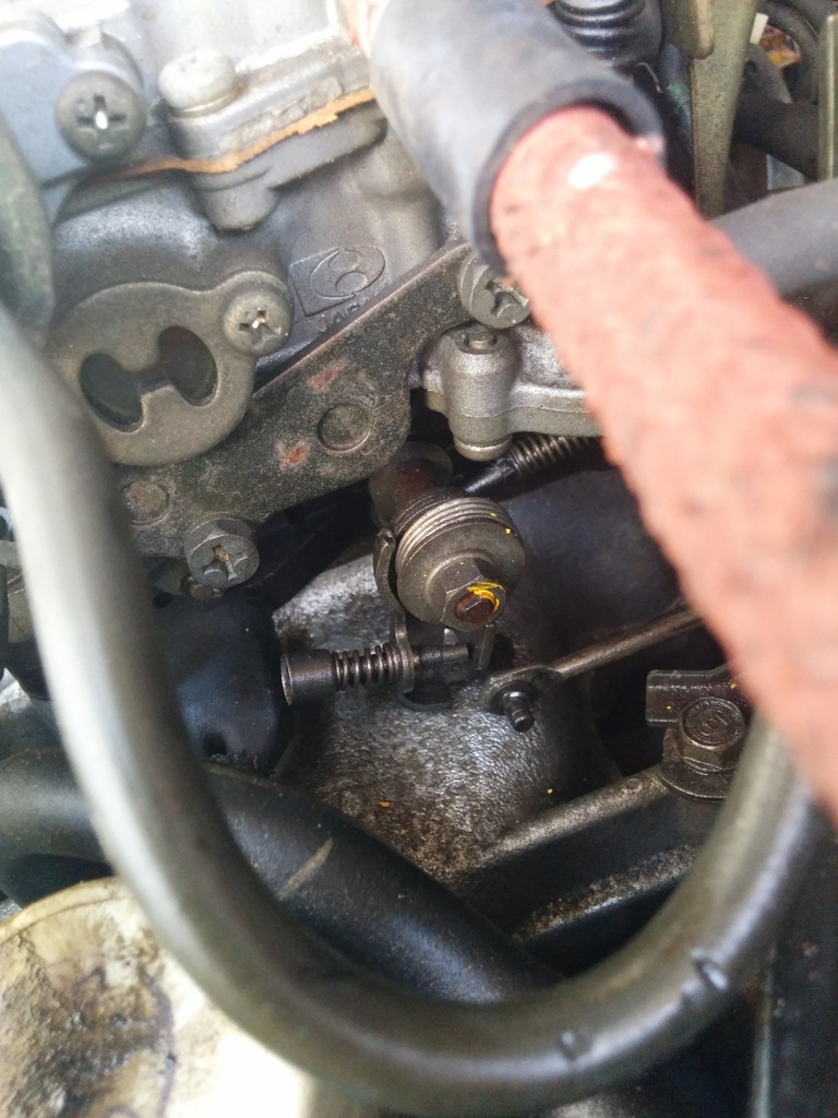

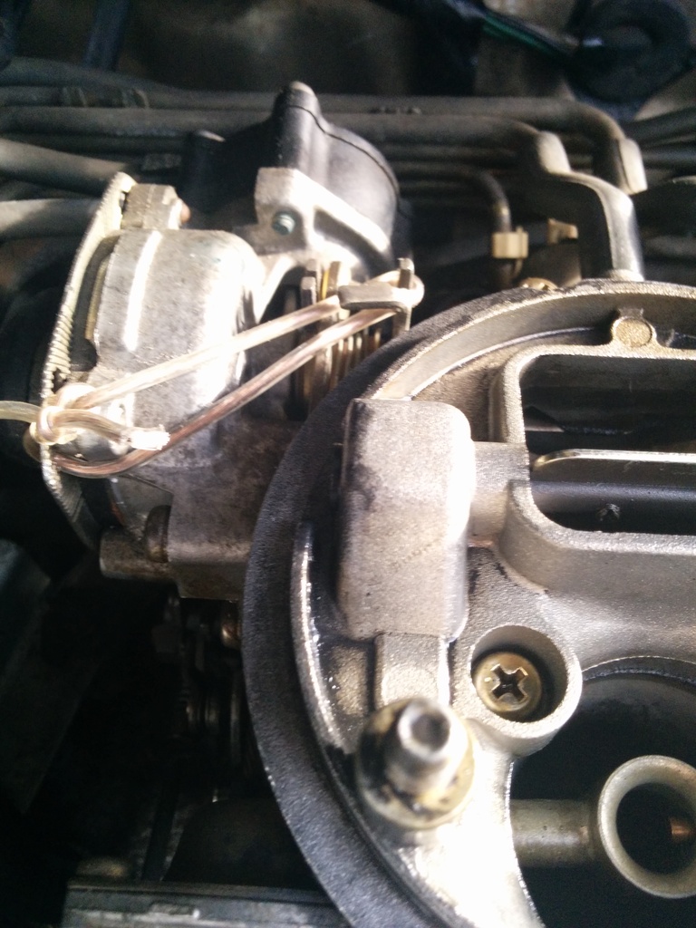

4) Some other kind of weird hack by the previous owner I just noticed is on the carb. One of the valves/springs has been tied shut (open?) on the left side. I have no idea what it does.

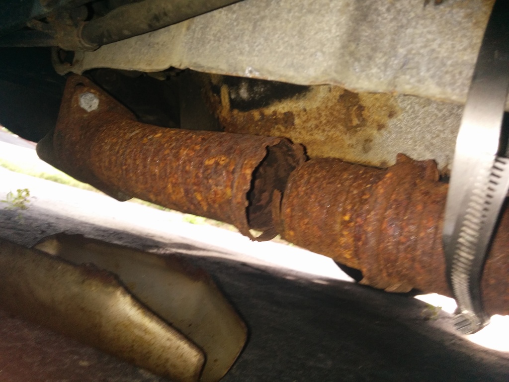

5) This one is my own embarrassment, as I don't know how I was so inexperienced that I overlooked it! There is a part of the exhaust pipe that has completely snapped/separated. It is the pipe not the muffler, but the pipe right ahead of it. Should I try to do some major tape/clamp job for now, or is the part pretty easy to find? Do you know what this pipe is called?
6) #7 looks like the metal part is a bit rusty but the line feels like it is on secure. It is very hard to visually see the other end of it (the end in the carb) but I wiggled it and it feels like the others.
