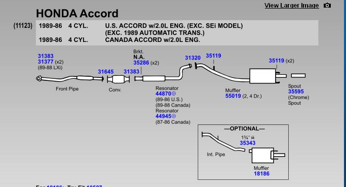

5. Can't place that pipe on the car by the pic? Is that from the pass side just in front of the rear tire going into the muffler? There are online diagrams of the exhaust system, you should be able to get a better idea.

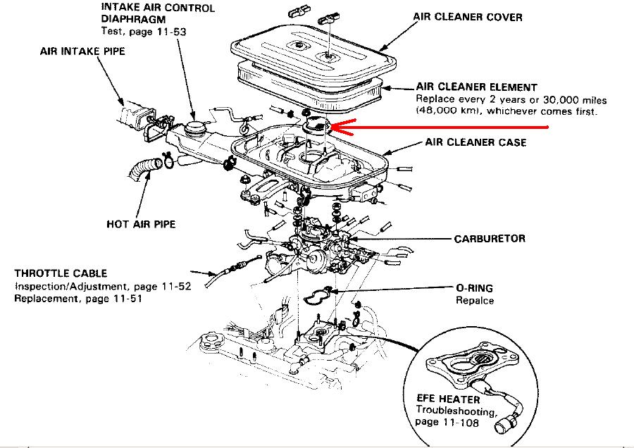

3) Yes, that is what I thought. There is currently nothing that is attached to the air filter housing. (where the top of the hose connects to in your pic) It would seem that everything points to the previous owner having issues with oil consumption / blowby (From what I have been reading elsewhere online). The hose from the top of the valve cover just vents to the atmosphere. I did not expect this from a Honda with 65k, but I guess if someone takes bad enough care of something this may happen. (let me know if I am jumping to conclusions, as I have not operated the car long enough to actually see how fast the oil is used, if at all) If I am correct, I have seem some discussion online about using a catch can and/or using oil additives to alleviate the issue. Have you ever had experience using either of these?

5) The part seems to be the 'resonator pipe' according to your (better than I could find anywhere online) diagram. Do you think any from a junkyard would last, or should I buy a new pipe?

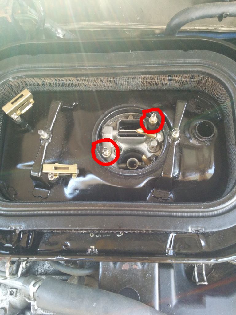

-The screws holding the carb to the air cleaner seem to be missing, as shown in the picture below. Is there anywhere I can get this replacement part?

For the air cleaner to carb mounting, from the factory there is a round "mesh-dome" that sits on the top of the carb that also holds the air filter base. Two nuts hold the dome down.....I'll look to see if I have a pic of the set up.

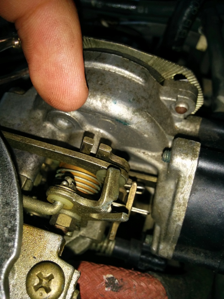

I tested out the choke today. Not much I can really explain.
I took off the airbox along with three hoses in order to view the action as the engine ran. All three of the hoses connected to the air cleaner case, so I did not originally think that there connection was needed to let the carb work properly, but seemingly I was wrong. I first took off the hack and let it run as seen in the video. I pressed in the gas to close the choke plate, started the car, and immediately ran around and started the video recording. Idle stayed at 3k the whole time and the choke did not seem to move besides opening about halfway. (How long should it take? waited just a few minutes but the day is hot) After this I put the hack back on (held open choke) and stated the car again - still stayed at 3k rpm. Finally I left on the hack and put all of the airbox assembly back - now it started at the usual 800rpm-1k range. Seemingly those three hoses are important to get the right idle, even though they only seem to go to the atmosphere?
One of the two hoses going to the automatic choke piece (the one with the orange band on it) had a small crack in the end right where it fit on the automatic choke. Possibly I could replace this - any specific type of hose I should use?

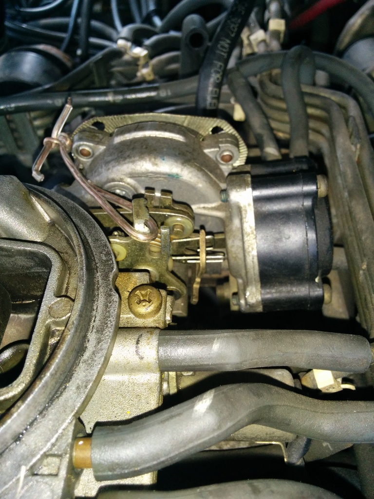

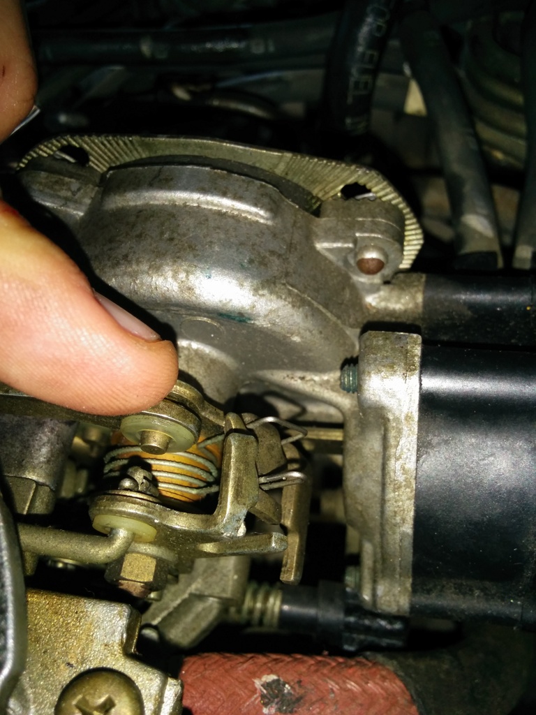

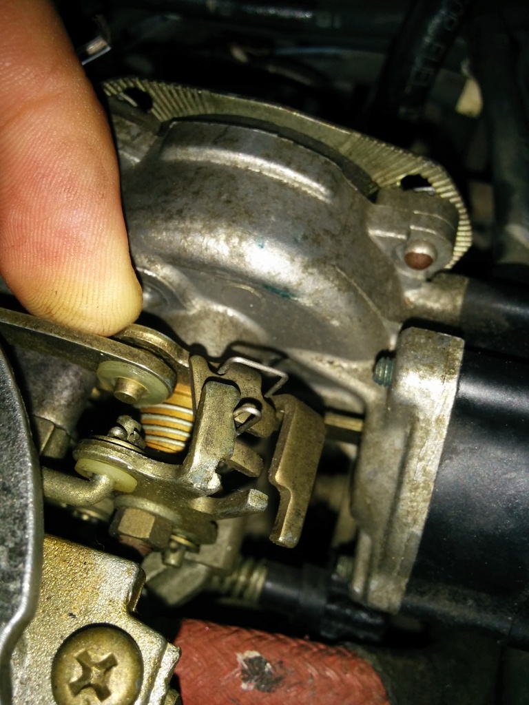

Finally, it seems like the choke does not open all the way even if I manually pull the lever going to the automatic choke thingy. I took a few pictures of the way the pieces link together, possibly this was modified in some way by the previous owner to make the hack, so it is not supposed to look like this?

). I tested out the choke today. Not much I can really explain.

Call me whatever you want
You should get a copy of the factory service manual for the car and do a little reading on this. It can get a bit complicated to follow so don't let it scare you at first...trust me 20 years ago when I first read it I was like "oh, hell no".
I have one where the whole manual is in one file, there are some on the internet where they come in sections but I found that they are missing pieces/pages.
The hoses to the air filter base are actually to "air bleed" valves and do play a part in this. Not sure which hose has a split in it but you should replace any that are broken/split.
