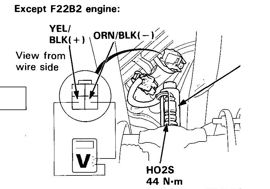

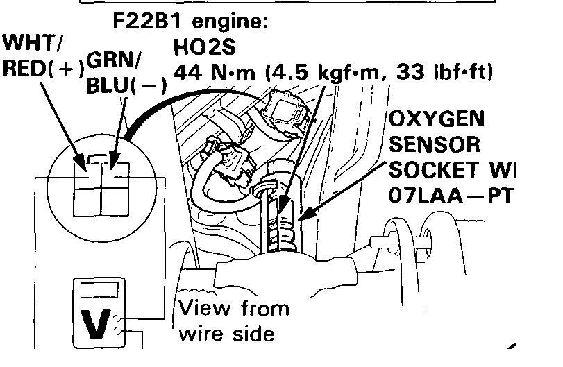

Did you sort out the O2 Plug? If not which side pulled out - Wire/terminal side or sensor side...then seen if you can confirm any other colors on the wires...or F22B1 or something else.
Attached Thumbnails three problems with 94 accord 5speed.-fb22-o2-wire2.jpg   three problems with 94 accord 5speed.-fb22-o2-wire.jpg

the four wires are 2 black 1 white 1 dark green i have a f22b didnt figure it out.

Which side of the O2? Wires coming from the sensor to the connector?
