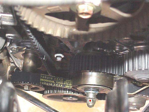

In the process of timing belt replacement on the '94. I just would like to confirm there is normally no bolt in the bracket on the timing belt tensioner - that bracket/bolt location is for locking it in place during install. The only bolt is on the outer bracket that secures the balance shaft belt, yes?
The factory manual shows a bolt there in most every illustration, but there wasn't one there on disassembly.
Thanks!

Your description sounds right. There is a bolt that is only used to loosen the tension on the timing belt. It should be removed once you get it installed.
The bolt that is painted white that needs to be removed before you put the car back together.
Attached Thumbnails Timing Belt Tensioner Install Quick Question - 94 EX-tb.jpg
