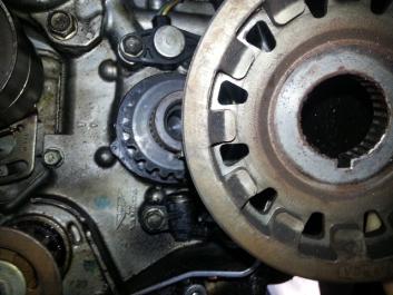

sorry it took so long to reply, and thank you all for your help, one last question before i slap this pupy together- on the harmonic balancer i have the black sprocket lined with the bottom arrow, now after ive put its belt on and reattached the brass sprocket, do i thin rotate the brass sprocket to align with the top arrow or leave it be?

When you say brass sprocket are you referring to the sprocket that the timing belt goes on at the crank?

At first I was confused by your photo, until I realized the left-side is actually the top. See the tensioner pulleys...
Right now, your crankshaft is 90-degrees away from TDC, so all 4 pistons are at mid-stroke. That's good. You can spin the camshaft any which way you want without worrying about piston/valve contact.
Line up the camshaft:
Arrow pointing roughly upwards. But the real timing marks are 2 little dimples out at the teeth of the sprocket. Line those up with the top of the head, or actually the top of that sheet-metal cover between the sprocket & the head.
Then turn the crankshaft directly to TDC, namely clockwise in your case. That's opposite the normal rotation of the engine, but it's important that you don't bring the crank through 180-degrees.
Then put on the cam-timing belt.
Line up the balance shafts & install that belt too.
